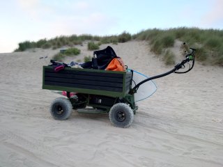

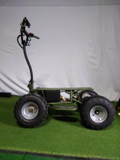

Hit me with your advice as to what components to change to make this better..
I have built this (Multi-purpose) Electric Utility Vehicle
See pics
It is a motorised beach cart when box is attached and handlebars are down
and Stand up scooter/ Golf buggy vehicle with handlebars in up position
I've nearly got it working really well it is just slightly underpowered when being ridden off road and on sand (I did just add the larger 6" wheels and bigger tyres for the sand in last pic)
It currently has a 48v 1000w my1020 motor with 48v 13ah hailong style 30amp BMS battery and flipsky 75100pro V2 controller
Riding it on flat pavement it is really good I have it topping out at 18mph at the moment and wouldn't really want it going much faster. If it could do that off road it would be great it just struggles a bit to pull up hills when riding off road and on sand.
I did a separate post about potentially going 4 wheel drive with this but decided not to as I don't want to spend too much.
but was thinking what should I do?..

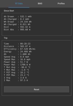

I have a screenshot attached of some numbers from a test run up and down the road..
I see it says iMax is this the phase amps I hit?
In vesc where do I see if I am hitting my battery limit?
IIRC, there was a tab that shows currents, rpm etc. as dials. Here continously changing current values can be observed.
If you are still not able to find out, let me know, I must be having an old version VESC mobile app built from sources somewhere (it has been more than a year since I played w/ VESC, was trying to install it from play store, now it is paid!). Based on the screenshots in play store, tab is "APPUI"
It says that some time during the trip, phase current has reached that value. This value will be easily reached at starting & low speed uphill. But what we are interested is the instantaneous phase & battery current (seen in the tab mentioned above) during the relevant riding condition.

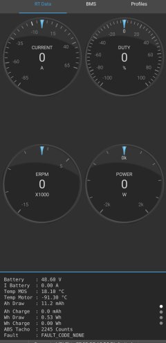

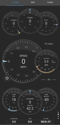

Thanks I have the real-time data screens (pics attached) but my vesc doesn't have the 'appui' page/tab it only has the real-time data tab
Regarding the current Amps dial is this not the phase amps on the motor side? Or is this battery amps being used?
