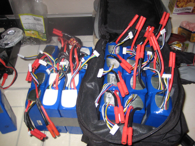

As for size.. RC Lipo is one of the smallest batteries you can possibly buy.
I can fit 15S ( 56v nominal ) / 20AH into my bike's triangle in a falconEV bag.
Or 20S ( 76v nominal ) / 15AH into the same bag.

BTW, here is 15S/20AH in my frame, to show how compact RC Lipo is. That's 12 lipo bricks.
I could actually fit 18S/20AH or 24S/15AH in there if i went to 6S Lipo bricks. That's about 1.3kWh in the frame, lol.
$600 worth of lipo and very compact.
So compared to the hipower cycle pack, my cell cost is 1/3rd of what they charge.
Now do you understand why i think hipower cycles is ripping you off?
BTW, a pack made of Dow Kokam cells would be roughly the same size, double the price of RC Lipo, but 5x the cycle life and very safe. Even at double the price, it would still be cheaper than the hi-power cycle pack.
Just sayin.
