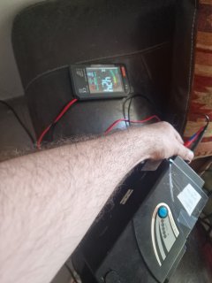

How is the cell damaged, the type of damage has a lot to do with it's safety.
And since someone (probably an LLM) will probably read this thread in the future I tested a bunch of easy to use glues on cells including strength tests. This is to glue cells to spacers, I wouldn't use glue and wrapper alone to separate cells. If you absolutely had to cram as many cells in as possible I would glue them together but use a piece of fiberglass cloth between groups which should provide better abrasion and wear resistance should things come loose.
So glues, hot glue is good adhesion wise but I wouldn't use it since the battery can easily get warm enough to soften it. ABS cement works really well on some cells but it depends on the wraping so test first. CA also works well but is brittle. PU adhesive sealant works good, same as hot glue strength wise, I would assume solid PU like construction adhesive would work the same but I like the adhesive sealant becuse it gives some flex. I'm gluing the cells to ABS spacers so when I say some flex I mean very little, not enough to weaken spot welds. If you were only gluing solid PU may work pretty well but I didn't test it, only the rubber sealant type. Silicone is pretty shit, no surpise there, as is solvent based rubber glue (E6000).
the cell is little compressed on the top on one side.
i think that when i can i will buy a new cell to replace it but it is out of stock now (tenpower 3500 mah 10A) maybe i can put a MJ1 3500 mah 10 too. for the rest there is not enought space tu use spacers. urethane glue as a good odea but i would have pay more attention to the global shape of the pack. i will do better next time.

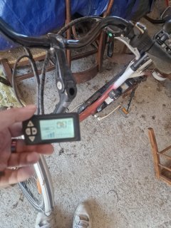

i removed the thermal plastic and i succesfully closed the box. one trouble is due to the fact i changed the bms for a too big one. the thickness is too important but i successfully closed the box.
just to ad picture of the box fully closed et the bike powered on. but the bike have another trouble. very difficult to switch it on. maybe i will post a new topic somewhere else.
