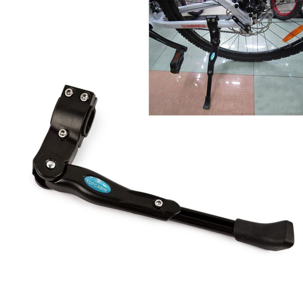

I am using this one: https://www.amazon.com/gp/product/B00FIKIK7C/ref=oh_aui_search_detailpage?ie=UTF8&psc=1
I installed it as close to the pedals as it would fit, and it works great. It is length adjustible but as some reviewers noted.. sometimes the screw is a tiny bit too long, and that keeps it from locking in place. I just tapped it on the belt sander and it worked perfect for me, but a quick hit with the file or sandpaper, or just adding a washer works just as well.
Its cast aluminum, and I was really surprised by how nice it is. I paid $12.70 so its a fair deal too.
just be aware that like all ebikes on rear mounted sidestands, if you have your batteries mounted up high and forward, it might be tippy with it installed too far back. keep it as close to the pedals as you can.
Heavy 60 lb ebike. That last one would turn on my frame, and started to dent the metal tube when I torqued it. I added a brace. It worked for a dew weeks, Then it broke in half right at the red mark.
I suppose the lesson is.. if it has enough stress to rotate on the frame, dont brace it, its too much stress for the cast aluminum stand.

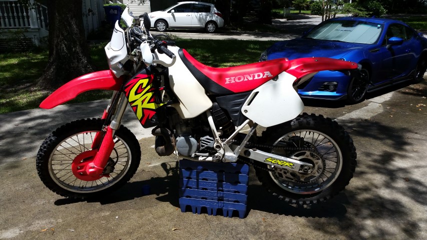

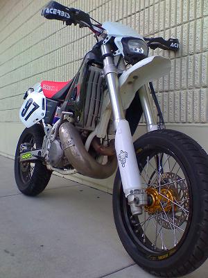

dogman dan said:
FWIW,, when was the last time you saw a kickstand on a motocross motorcycle?
Every morning!
View of sidestand folded up:
and in use:
Its much better than my old method of "find a wall":
Well, two of those pictures are enduros. I guess I'm out of date, I thought a race bike was stripped of every gram of weight that does not help it win. If the bike is just for recreational dirt riding, a stand would be ok.

Those are my CR500s... with little Farkles of "lights" added so the "police" dont "arrest" me with their "laws". Its still a straight up motorcross/supermoto bike.
And no, they are not stripped of every gram of weight to win. They're overbuilt a bit to last massive abuse.
Its only the new 4stroke era where you have the oh-my-god-how-do-we-get-this-pigs-weight-down-to-something-reasonable mentality of making a motorcross bike as light as possible.
