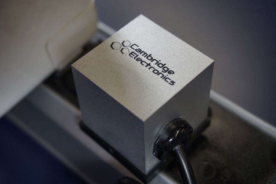

Gallium nitride electronics could drastically cut energy usage in data centers, consumer devices.
"...GaN transistors have at least one-tenth the resistance of such silicon-based transistors, according to the company. This allows for much higher energy-efficiency, and orders-of-magnitude faster switching frequency — meaning power-electronics systems with these components can be made much smaller. CEI is using its transistors to enable power electronics that will make data centers less energy-intensive, electric cars cheaper and more powerful, and laptop power adapters one- third the size — or even small enough to fit inside the computer itself..."

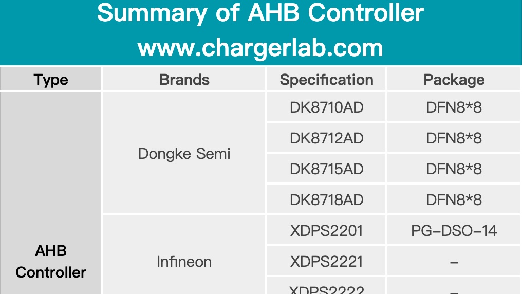

I did find this while looking to see if they where in any E-bike products yet;
"...Compared with the traditional flyback controller which consumes the transformer leakage inductance as heat, the AHB controller not only recycles the leakage inductance but also realizes zero-voltage switching of the main MOSFET and zero-current switching of the synchronous rectifier, reducing switching losses and heat generation....
...AHB combines the advantages of the flyback converter and the asymmetric half-bridge, utilizing the excitation current to achieve MOSFET ZVS (Zero Voltage Switching) and the resonant current to achieve secondary rectifier diode ZCS (Zero Current Switching)..."
The bottom bits are all the manufacturers that have adopted the above.
