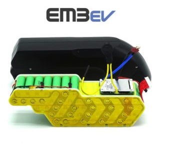

One thing that concerns me about the Leaf 1500w motor is that while it is able to run cool and efficient at 2000w (with the appropriate sized wheel) I don't think the average shark battery pack from EM3EV will be cool and efficient if used with such a combination.
For example, Samsung 35E cells are rated at 8 amps max continuous current. Since the largest shark pack from EM3EV holds 70 cells for 14S 5P that puts the pack's maximum continuous current of 40 amps (re: 5 x 8 amps = 40 amps) and yet going 40 mph with the typical bike from this thread will pull more than that thus pushing the BMS into its burst mode of 55 amps maximum.
Even the EM3EV Triangle battery pack at 14S 6P looks inadequate for the average bike build in this thread:
So if a person wants to push 40 mph with the chassis commonly found in this thread the battery should likewise be much bigger in order to match the efficiency of the motor. Pushing small batteries to max continuous power draw is hard on battery efficiency as well battery life.
Best to choose a bigger battery in order match discharge efficiency with motor efficiency. What is the point of having a motor with 90% efficiency at speed if the battery is simultaneously poorly efficient. In some cases (e.g. chassis limiting battery size) perhaps it is better to have a motor with less efficiency but with higher torque per amp when using certain small batteries.
For any ebike build, you need to match the motor, battery, and controller to the application.
The battery has two separate components that can be limiting factors...the cells and the BMS. Although the Leaf motor will do it without over heating if you run Statorade, there are better choices for a motor if you want to cruise at higher speeds...QS205, Cromotor, and the Crystalyte H55100 would be the motors I would recommend. The Crystalyte has a 55mm stator.
EM3ev is very conservative with their recommendations but if you follow them, your battery will last a looong time...they recommend ~50% of the max capability of the cells for "burst" current. I have a 14s6p battery from them that is over seven years old and still going strong. I also have a 14s4p battery from EM3ev with 25R cells and I pull ~60A every time I start from a standstill but pulling that much continuously like you would need to do if going over 40 mph, is not a good idea. The 25R cells are rated for 20A continuous by the manufacturer so with a 4p pack, they can provide 80A continuously...but just because it can do it, that doesn't mean it is a good idea. The limiting factor with most batteries is the BMS and not the cells.
Most ebike motors will start to decrease the torque per amp when you go over ~40A battery current and by ~60A, it is really noticable. The Grin Tech Motor Simulator does not account for saturation...I found it experimentally. Saturation is not an ON/OFF switch, it occurs gradually at first and increases as you increase the amperage...until you are just pouring more heat into the motor as opposed to getting more torque.
In my experience, most ebike components can handle 40A and if you stay below that threshold, you'll never have a problem. But as you go over about 40A, everything needs to be resized, replaced or at least evaluated to see if it can handle the amperage.
In the link below EM3EV states "We would recommend the cells be ran at roughly 50% of their max continuous ratings. Of course they can provide the full discharge, but there can be voltage sag and reduced capacity if this is done."
For a 35E cell that means 4 amps per cell.
It's not the motor I am concerned about, it's the battery.
For example, lets say our target is 40 mph with 2000 motor watts and this is achieved at 85% efficiency (as stated by neptronix in the second link I provided). This means the controller needs 2353 watts (re: 2353 x .85 = 2000.05 watts) from the battery. And remember the battery itself will not be 100% efficient at delivering these 2353 watts to the controller. Yeah definitely a person wouldn't want Samsung 35E, Panasonic PF or Panasonic GA cells in a the EM3EV Jumbo shark 14S5P pack for this purpose. Unfortunately the Samsung 35E and Panasonic GA are also the highest capacity cells.
That leaves the high discharge/low energy density cells (Samsung 25R, Molicel 28A and LG HG2) as the only remaining choices. The Samsung 25R is actually very good at discharging high amps efficiently though it is the lowest capaciy cell sold by EM3EV. I don't know much about the LG HG2 and the Molicel 28A other than they have high maximum continous discharge of 20A and 35A respectively.
But if your BMS is limited to 40 amps continuous these cells don't help for continuous operation of the goal. They may not even help a person momentarily hit 40 mph (via 55 amp burst mode of BMS) on flat ground with no headwind for various reasons including non ideal tire diameter and motor winding selection. Then there is also efficiency loss occuring at the level of the BMS to think about when the BMS is operating in this "burst mode".

If you have 35E cells in your battery and you have the EM3ev smart BMS, you can safely pull 8A per "p" string but your battery just won't last nearly as long as it would if you pulled 4A per "p". If you have a 14s5p battery with 35E cells, the run below shows you can only get about 35 mph with 40A assuming you are sitting upright.
The 2000w Leaf motor that is 135-137mm OLD is the exact same motor as the 1500w Leaf motor, they just say 2000w because at 60v you will pull about the same amperage as running it at 48v and 1500w. It is the amperage that does the heating and not the watts or voltage.
The EM3ev Smart BMS is rated for "40A continuous plus". 40A with a 52v battery will get you 35 mph with the 4T Leaf motor and I included the Crystalyte 3548 motor to get a good estimate on the temperature for the Leaf...obviously you will need to run Statorade to keep the temperature acceptable if you are running a 26" wheel...I used 686mm because that is the OD of a Maxxis Hookworm 26x2.5" tire:
So you basically have two choices if you want to ride at speeds above 35 mph:
A. Get a new and/or an additional battery. For the "additional battery", you could wire another identical battery in parallel to double the amperage available but that has its own unique challenges.
B. Reduce the top speed you want to achieve.
Reducing the aerodynamic drag is another approach that could help but it may require a completely different vehicle and that is why I did not include it.

Running any battery at close to it's maximum output will produce a lot of heat in the pack and this can reduce the pack's life significantly, you also risk overheating the battery which could cause it to explode.
Smallest battery w/1-3C cells i'd run is 23AH. That way, at a 35mph cruising speed, you're running about 2C. That's still producing some notable heat, but it's at least bordering on 'bad'.
Preferably you have a 30-40AH pack instead.
