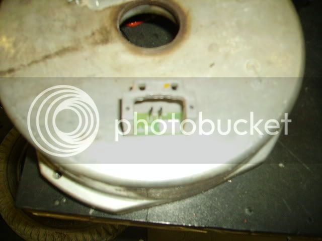

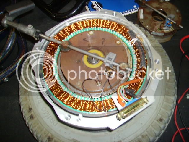

I got this brushless motor off of a wheelchair about a week ago and though that I would play around with it. The motor is designed for 24v and provides a considerable amount of torque, enough to haul someone much bigger than me with more weight (in a wheelchair) alot faster up a hill than my scooter can do. I'm not so sure if I can use it with a scooter controller though. The motor has 3 power leads, which is good, but then the 5 wires that I thought were for the hall sensors have me a little less convinced. 4 of them go straight to the small circuit board in the fuzzy picture below and the last one (black) seems to be a ground or neutral wire.
Here's the motor. The big, rusty coloured thing in the middle is a brake and will be removed.
The thing I expected to be a hall sensor. Sorry about the terrible picture. The big white rectangle on the bottom right of the first pic is for the wiring harness.
Any ideas, people?

If you can get a better picutre of the little circuit board, we might be able to tell if it has hall sensors on it. There should be a way to test the board, but it would be good if you can identify some of the parts on it first.
Worst case, you could run it with a sensorless controller.
Yes, it is a DC motor. What made you think it wasn't?
I know that the circuit board works, as the motor works on the wheelchair controller. I'll try to get a better picture of the board. If there are hall sensors on the board, they don't look like any that I've ever seen. If they don't have any, where would I find a sensorless controller? Never heard of that.

From the picture, it looks like it would be relatively easy to install hall sensors if you can figure out the right spacing for them. The sensors just need to pick up the flux from the magnets, so it looks like you could glue them along the edge of the stator so they sense the sides of the magnets. On Crystalyte motors, there are little recesses milled into the stator iron for the sensors. This approach might work well too.
If the motor runs with the existing controller, you should be able to measure the voltages on the wires coming from the sensing circuit to determine their function. With the power on, measure each wire against battery ground while very slowly turning the rotor. If you do that, we should be able to figure out the wiring.
