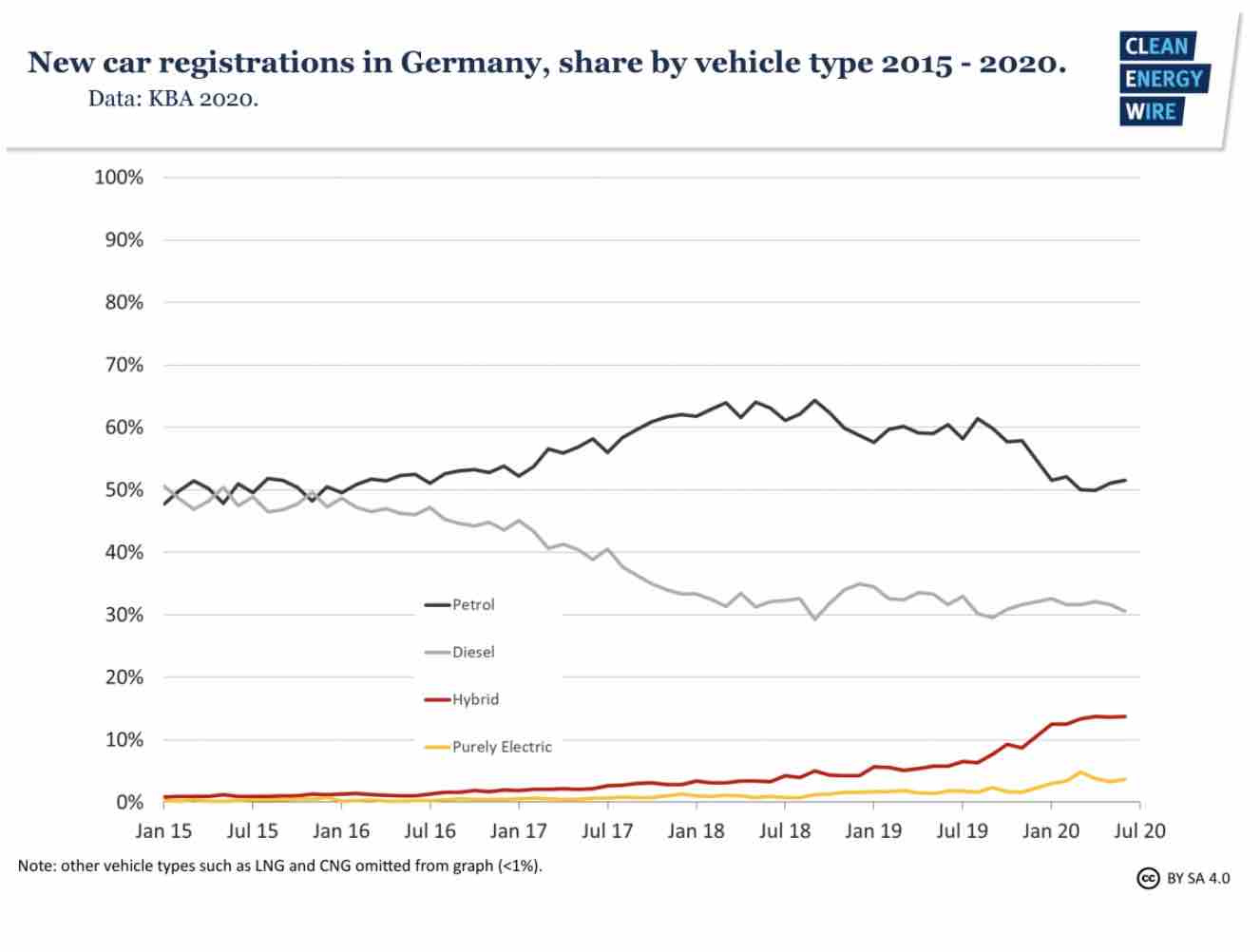

Main problem so far is the transport sector. People buy more and more heavy cars.
But in 2020 electric vehicles sales finaly start to increase:
With the CO2 price in the buildings and vehicle sector (BEHG) starting in 2021 we will see much quicker electrification of the vehicle and building sector.

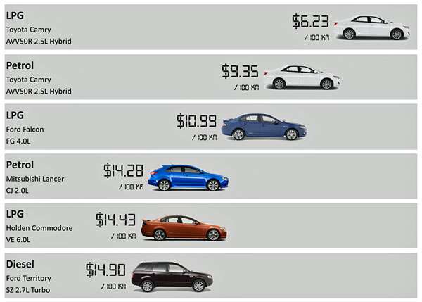

Cost wise Autogas LPG is steady at 70-80C/ltr compared to petrol at 110-160C/ltr and unpredictable
So the savings are still there.
I wonder if the cab companies realise they can have a “Tri Fuel” hybrid these days ?
?? Obviously only a comparison , since i know of several current cars that will equal those $6-7/100km costs , just running on straight petrol or Diesel.

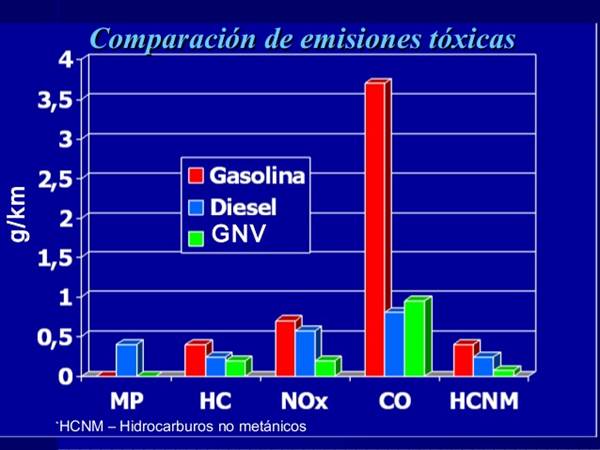

It is quite difficult to find a graphic on emission comparisons between LNG, CNG, diesel and gasoline CARS.
It usually is one bias this way or that way.
The English-language publications focus on buses and trucks with significantly more efficient catalytic converters and far fewer cold starts. Furthermore, in the USA the ecological disadvantage of fracking natural gas must be taken into account in a WTW analysis.
CNG friendly sites mostly ignore the CO, diesel friendly sites mostly use completely unrealistic parameters for diesel exhaust gases.
This one is from Spain and includes CO:
You will find other pictures with other data.
Afaik the most significant air pollutions in (German) cities today far are NOx and PM.
CNG (and LNG) has a huge benefit on PM emissions and a saller one on NOx vs diesel and gasoline.
