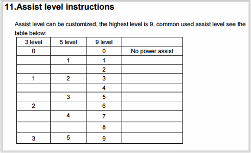

When I'm in 3-level PAS mode there is no way PAS 2 is mapping to my Controller's #6 as page 11 in the DPC-14 manual indicates. I've programmed a substantial power difference (40% vs 60%) between my PAS 5 and 6. In this test PAS 2 behaved almost exactly like my Controller's #5 setting. I think the dpc-14 manual is not entirely accurate and that a better approximation is that controller levels 3, 5, and 9 are used. It turns out this works really well for me because if you look at my PAS 1-9 settings in the controller programming (prior post) this means in 3-level PAS mode I get an increase in power in each level: 25%, 40%, 50%. That's about 350 watts at most and is enough to get someone up to around 20mph but not much beyond without substantial pedaling.

Section 11 from the DPC-14 manual
