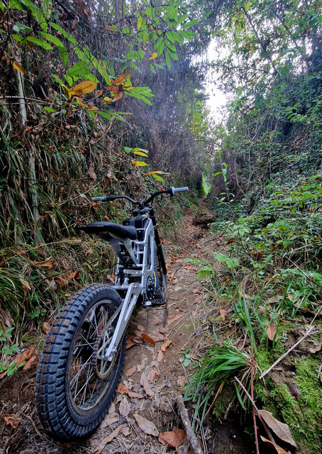

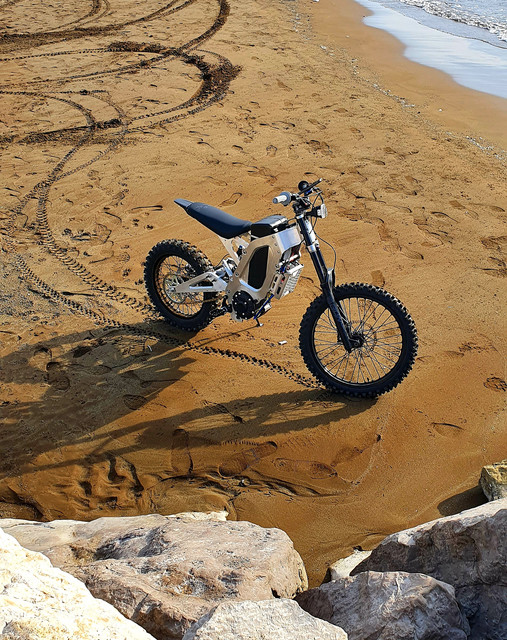

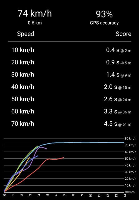

BigBlock said:I did some accelaration shot to tune the controller. The knobby tires does not provide good traction on street.
However it can easily win on 0-60km/h vs my KTM 350... it's insane
I still have RPM limited to 75%. I should arrive to 85Km/h max speed with this sprocket size (48t).
Some video coming soon.

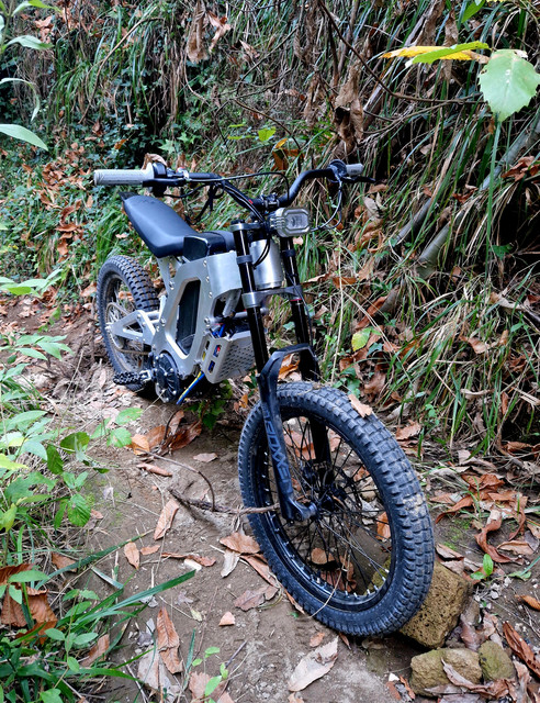

You are right! I couldn't find the right lenght bolts with 10.1 grade spec... I'm going to replace them soon.Mourningstar said:I love everything but the long studs sticking out of the swing-arm.

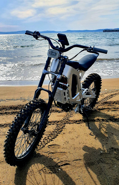

owhite said:BigBlock -- what rims do you use?
BigBlock said:owhite said:BigBlock -- what rims do you use?
Good quality rims are becoming pricey and very difficul to find (especially in 16' size) - I bought a decent couple of aluminium rims on Aliexpress and laced and balanced by self. Sometime I needed to slighly machine it to better round. But it works for me faster anche cheaper than buy a fully built Excel wheel.
Eastwood said:The bike looks so good! Do you have rear linkage for your rear suspension? It looks like it I’m sure that helps a ton!
