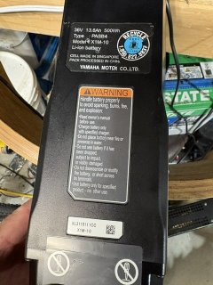

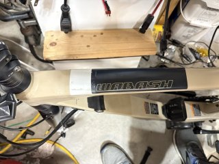

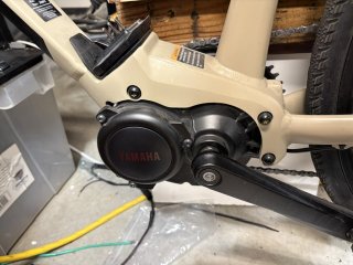

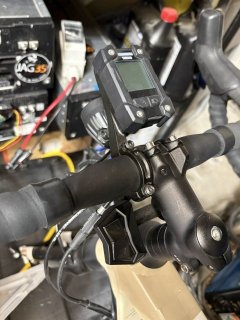

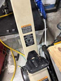

Would this work for a yamaha wabash rt bike built for the US market? Thanks!
