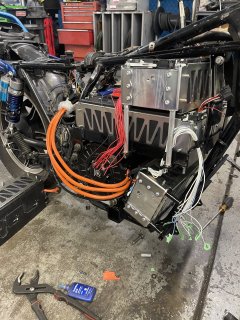

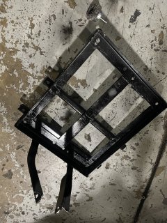

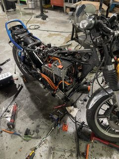

Well this wasn’t the original plan but since they technically fits it will have to do for now. Here’s the battery tray and rough IMG_5891.jpeglayout. IMG_5889.jpeg
Wouldn't it be possible to have two modules standing in front of the motor, then two laing down behind them?
Like the one you have on top now, but behind the two standing up.
I see what you’re saying. Unfortunately the two in the front would leave no room for the ones in the back to line up.

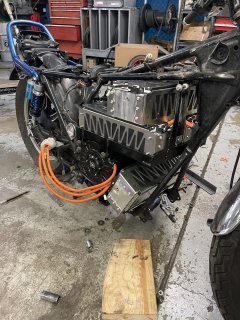

It’s not ideal nor how I thought it would look. It they’re mounted. Using standoffs to keep them from touching. Or laying on the frame. This also gives me space for the leg rests. IMG_5906.jpeg

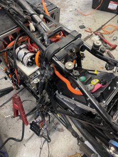

Got the FarDriver controller mounted Eve though it’s enormous, it fit nicely under the seat after I welded a bracket to the frame for it.IMG_5955.jpeg Just some more wiring and we’ll see if it runs.

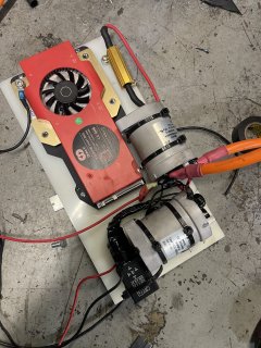

Got everything wired up the bare minimum to run and it’s alive! Had a good scare when it kept setting an encoder error message. Had to change the encoder model and thankfully that fixed it. I got most of the 12v stuff wired up. I had planned on just leaving the original harness and tapping the 12v converter directly to the original fusebox but I decided to just rip the original harness out and use the supplies one and just run the required wiring. One thing I strongly suggest is replacing the 22 gauge main 12v power and ground wires with something thicker and a better fuse holder. These Chinese harnesses are notorious for cheap wiring.

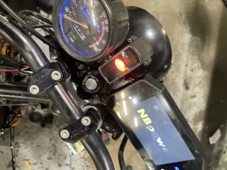

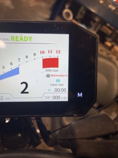

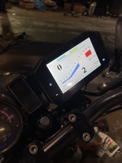

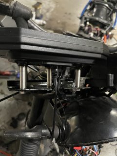

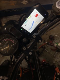

I got all the lights wired. I wired the precharge relay to the oil light so when the precharge contactor comes on it lights then goes out when the main kicks in so you know when you’re ready to go. Also made a bracket for the display included in the kit and wired the turn signals and high beam indicator into it. It’s pretty cool the display turns from white to black when you switch the high beams on. I can’t find any info on this display but it has a usb port so idk if it’s programmable.
I kept the original analog speedometer on it for a nostalgic look. It runs on the front wheel so it will still keep speed and more importantly the odometer.

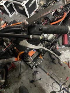

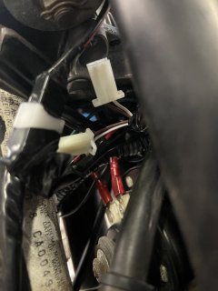

I’m trying something a little different. I’m using the clutch lever as the motor cut/regen. This leaves the front and rear brakes as they are. I cut the original cable down and put a spring on the end and am using the clutch switch as the low brake input to the co troller. IMG_5986.jpegIMG_5987.jpegIMG_5984.jpegIMG_5990.jpeg

While I’m waiting on the chain I’m finishing up some wiring and programming the display. As I said there are no instructions with the display but after a Google image search I found it. It has 2 connections that I couldnt figure out. Apparently this display has a built in radio/ Bluetooth and those are for speakers! Also I’m assuming the usb is an input for an iPod or something but I’ll use it for charging. I don’t know if I’ll be listening to tunes while I’m riding but maybe I’ll just blast some Harley sounds out to freak out the Harley guys.

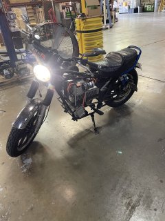

It’s alive! It’s definitely sluggish off the line like you guys said. I got it up to 60mph and it’s still pulling. The front brakes aren’t working so I figured I won’t go past that, you know cause brakes are important. Everything for the most part is staying cool. The controller is gettin warm to the touch but it’s also 100 degrees out. The display isn’t reading speed or rpm. Maybe it’s mad I switched it from kph to mph. Still have to modify to gas tank to get it to fit and some other small stuff but gearing is most important right now. The chain is a little noisy but it’s also a cheap Amazon chain because I’m not going to butcher a new one until I know what gearing I’m using. IMG_6017.jpeg

Looks good. I know you're going to add coverings and tidy it up, but for now the naked electric look is really neat
Thank you. I’m gonna leave some of it exposed. Probably a decent amount. I still need to cut the tank down and cover the electronics. Then I’ll take a step back see what I want to do from there

while I’m waiting on the sprocket I got the display mostly dialed and cut the tank down to fit. Definitely need a cooling fan or two for the controller. This thing wants to go! Can’t wait to ride it with the higher gearing. IMG_6055.jpeg
