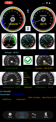

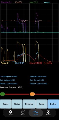

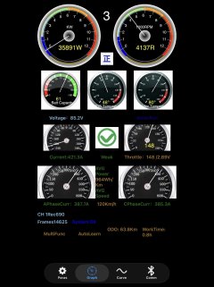

I don't think you should maintain high speed, running unknown amounts of fw etc. without monitoring the motortemp..
It doesn't sound like your settings are ok if you loose power at full throttle, I think you should lower your currents a lot until you have found better settings.
I ran a fardriver nd961800 in the beginning, and I used the tempsensor. I don't remember how I set it up, but it might be in the thread.
The motortemp is also important for the controller to know when it is calculating its timings etc. So not using the sensor can very well be part of the tuning problem.
