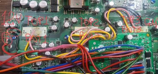

Controller is re-installed on the bike after sealing and additional connectors (see 7).
I did an extended test run (emulated commute on Sunday evening, up to 90km/h and 20°C->~40°C in the uphill leg) and deemed it safe to commute for real today. See my build thread as well.
View attachment 337049View attachment 337052
However I'm still struggling with the launch performance. Once it reaches 15 km/h and FOC kicks in it's smooth and seems to deliver full power up to the configured limits.
Post initial configuration with Roger the journey was as follows:
  • transition to FOC was rough & unreliable at 1500 eRPM
  • dropped phase current from 300 to 150A, re-autocompleted at 200A (for higher error currents) and items further down then just reduce phase for this tweak. Note battery current is limited at 150A due to fuse and contactor ratings.
  • consecutitvely raised i\R from 53 to 90 mOhm, which got me going
  • I have it now at 175A and 100 mOhm, which is still reliable:

Since then I tried to tweak the transition:
  1. D\f (erpm dr2 jump to dr3) from 1000 to 750, which is too low even on N\h (minimum # of cycles going from drive 2 to 3 = 5000), 900 is OK even on 2000 cycles.
  2. 190A phase is too much for a neat transition even at D\f of 5000 (still based on 200A)
  3. G\g (phase control loop, drive 2, 3rd order) autocompletes to 0.03 but as per Roger's recommendation is 0.3, tried doubling it to .6 to see if I get better acceleration under Drive_2 (Halls), but did not notice a difference, so reverted
  4. G\n (immediate motor phase step) autocompletes to 64 and was at 16 per Roger's recommendation (for hub motors), tried 8 (more "jumpy") and now 24, which causes a bit of humming but feels more responsive. This value seems to affect both Drive_2 and Drive_3 (FOC)
TBH, I don't have a full understanding of the parameters but I can change a value at a time. I'm especially wary of increasing the error currents (I only autocompleted based on 200A instead of Roger's recommendation of 300A) until I'm a little more confident.
I might try calibration based on 250A next and a phase current of 190-200A.
Edit: tried the 250A, autocomplete then 190A phase current settings this morning. Worked OK, but the transition has become more "rough" and it conked out once (only) on an incline.

I am working with Lebowski inverter to use as a simple sensorless controller with IMA hardware.
I use my own board which i made according to Lebowski SMD schematic.
The problem starts when HV current is applied...
Whenever i start IMA inverter i get 2.5V on current sensors and normal signals
Then inverter starts chatting with motor back and forth... after several seconds Lebowski would go to 3rd LED (blue) and stop. When i measure sensors i get 0.205V!!! What is wrong here?
Also i cant calibrate current sensors or do a FOC measurement as IMA goes belly up before this could be done...
My parameters...
Deadtime 3.5ms
Signal polarity High
current sensors 6mV per A
I use 360Vdc from 250A fuse
Leaf motor EM61 for now in sensorless
It seems like inverter would get shut down. Would that be the main uC chip? I didnt remove it or cut it anyhow....
Also one detail i didnt connect GND from driver signals anywhere. Should i solder wires there and put them to my chip GND?
Nor have i connected any other GND besides the main pin on the input CAP. I assume all GND is done by the mainboard? Should i connect them and risk ground loops?
Also i see dsPic30 chip is getting hot...
OK i carefully applied hot air and removed the main chip off the board. Then i reassembled the inverter and went on to test my work...
Sucess!!! After i removed the chip inverter no longer stopped after a few seconds. I even managed to apply throttle and get some movement on the motor.
I also made all applicable connections from all GND connections be that drivers or current sensors into a star connection with main GND line to avoid any ground loops...
Sadly i went on and tried to get the current sensor calibration and FOC measurement from inverter. Both went off good but with FOC measurement motor started to vibrate and there was a loud bang from inverter... i think IGBTs are toast. DOH...
But i proved it will rotate Leaf motor... it will just not take the abuse.... will follow up with post mortem.
If you followed Tom de Bree's Honda Ima guide when you wired up the gate drives the Lebowski controller will not work. The gate drive high and low sides are incorrectly marked. I blew an IMA inverter discovering that myself.
There are multiple reasons why it is best practice to use twisted pairs for your current sensor signals back to the Lebowski controller board. The cost to follow best practice is literally zero especially considering the importance of the current sensor data to the control algorithm . I have an IMA lebowski and EM57 on my bench now, if you post your hex file I would be happy to take a look.
Well i didnt actually use Toms manual where the top pin is actually called a bottom gate.
I used this sketch from Romale... and i still managed to broke inverter...DOH!
Is the HIGH driver orientation correct for IMA?
Also i used 3.5ms deadtime and i thought it was ok since everyone used 3ms before me...
I will post hex file here...
The critical error that would have stopped the motor running is in menu d) sub h) the values of 1, and 0.49 won't work. I usually use 18, and 24. Check with Eric, he has tried a much bigger spread for the ramp that seems to working well with his FIAT 500E transaxle powered kart. Also in menu d) sub e) try 800 in there. You really want to stay in sensorless and you also want a bit more hysteresis there. Keeping notes from anything thing Bas has said on settings, the current thinking is that menu f) current sensors you should just restore calibration and leave it that. The magnetics in the current sensors have short term memory so the offset can move around so you are trying to chase a moving target with offset measurement. You can see that effect if you perform multiple measurements, the numbers jump about and in all likelihood none of them are correct for anything but a single instance in time. If you have massive sensor offsets focus on the root cause.
If you want regen you also need to enable throttle 2 in menu c).
I basically changed d) sub e) switched off use acceleration limiter. Set my battery voltage, reset current calibration and the leaf motor spun up in sensorless first time using an IMA inverter. Do double check the gate drive connections. And yes the gate drive polarity on the IMA is active high unlike the Volt/Ampera inverter which is active low.
