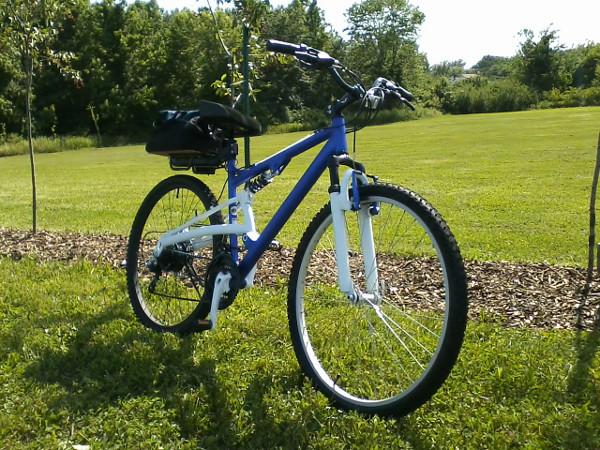

Here is the "Before" shot of my bike. It is a Cheapo Walmart Genesis v2900 29er:
I am going for a somewhat stealthy look so hopefully other than the rear rack, it will look almost the same:
After:
Still gotta convert the front to disc brakes and then paint it but it is essentially done. Its nothing special but its mine, so I like it :D

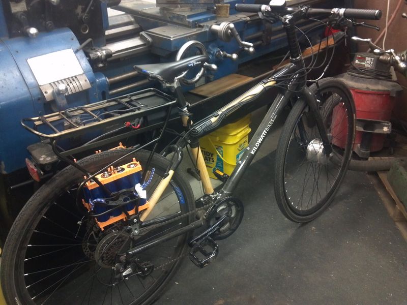

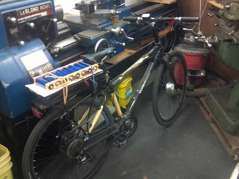

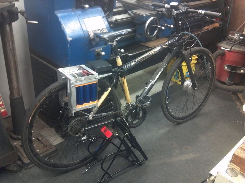

I picked this up in trade with no battery or charger
Got new Headway cells locally. Weight is too high.
Making a new battery rack. Look how much lower the weight will be. Can't hurt.
Almost done with the rear battery rack mock up. A few more things to tidy up and skin it.

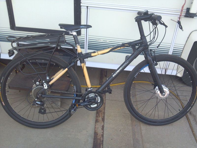

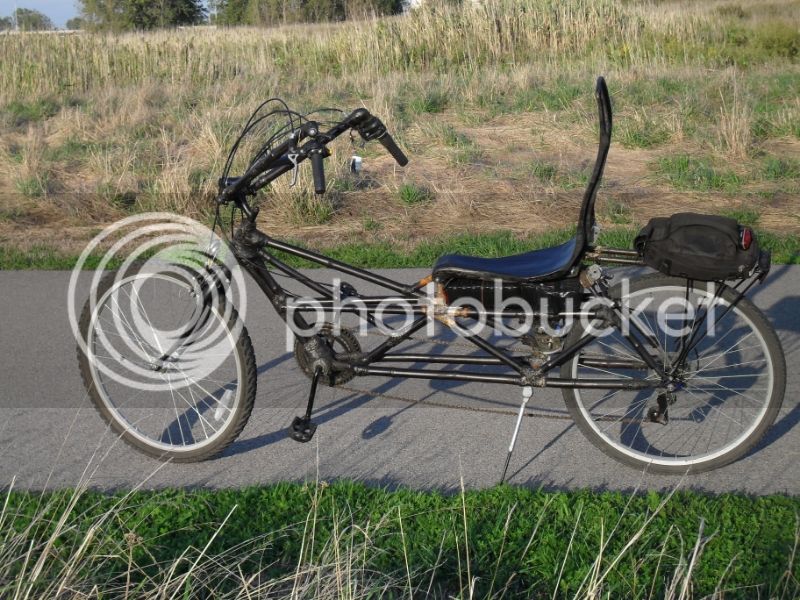

Hello everone,
I finally figured out how to put pictures on endless-sphere so here are some before and after pictures of my bamboo semi recumbent ebike.
It start out as as a huffy mountain bike that I put a heinzmann 24v brushed hub motor set up and a "china girl" ICE kit on.
When I used the electric and ICE together off of a red light, I could keep ahead of trafic no problem up to 30mph. Was fun for 2 years until the engine blew out. The heinzmann died shortly after.

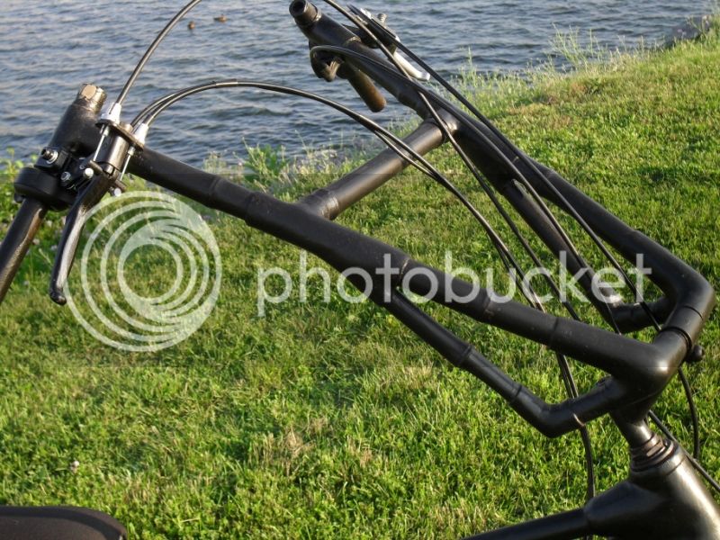

Old injuries to my neck and lower back started to become more of a problem for me( two car accidents I was in years ago) and it became apparent I would not be able to ride a standard geometry bicycle anymore. So I cut up the huffy, made a jig out of scrap wood, got some bammboo,hemp fiber and some epoxy and made my Bambooster.

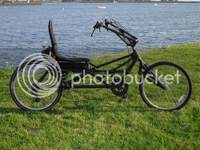

This is it early last year. Still rough and before I made the bamboo fork or remade the bamboo handlebars. Seat is still exposed wood.
Here's how it looks today.

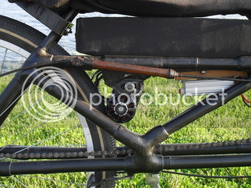

It's a Kepler/Adrian style drive, the reason for calling it "Bambooster". It is running on a 6374 rewound to 10 turns with high temp. with 16 gauge magnet wire and fitted with internal hall sensors at 120 deg (had to file a little bit of the stator back to squeeze them in to the slots). its engaged by cable and the old clutch lever from the dead ICE kit. A duel brake pull lever takes care of front and back brakes.

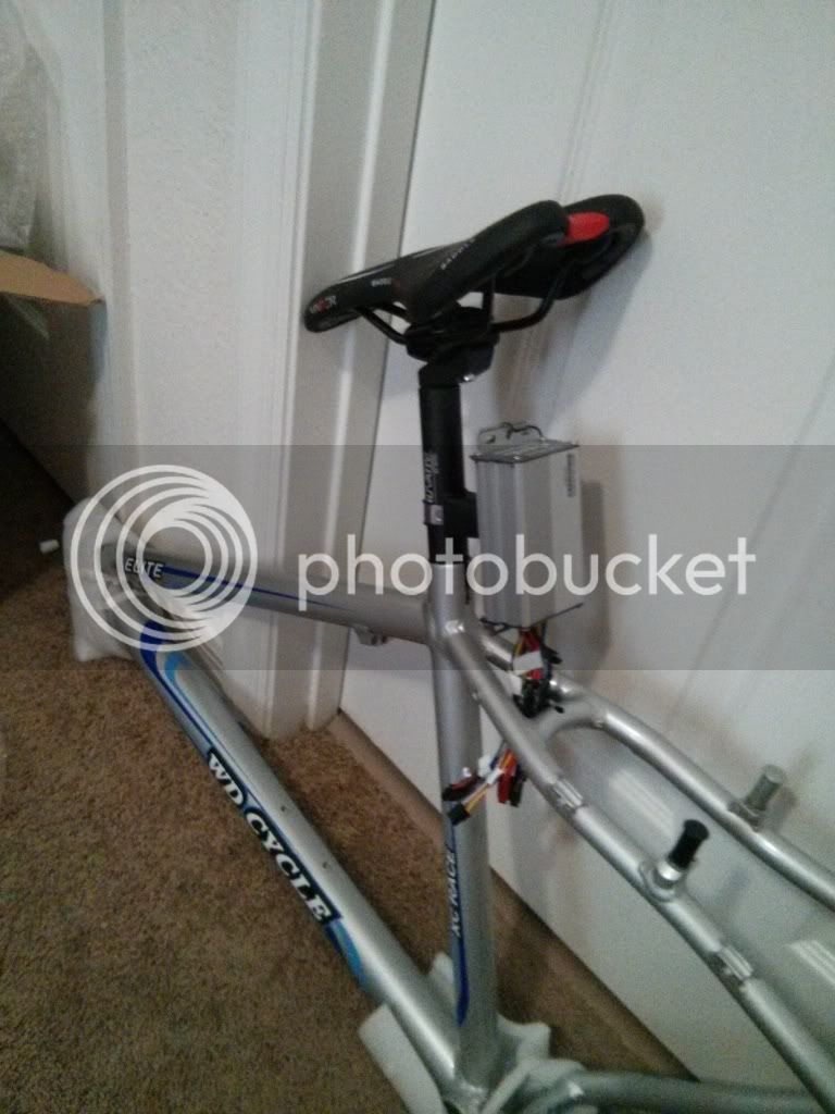

My project, Giant Warp
* New build frame
* Mac motor kit
* 72V battery
* Cycle analyst
