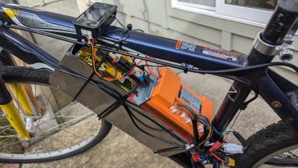

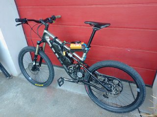

Motobecane Hal Boost Eagle 27
I just got into mountain biking last year. My knees aren’t so good so the option of an electric motor made it possible. I paid $1699 from bikesdirect. Seemed like a decent price.View attachment 291295 [attachment=1]1D7CB75A-9B53-43E8-B4DD-41641442C8C6.jpeg[/attachment
I added the 100 mm BBSHD w/42t chainring and 52v 12ah battery. 27.5x3.00 tires
The bike rides very well off road,it works great in all 12 gears. In highest gear I can pedal comfortable up near 30 mph.
Only 2 things that bother me are the battery not fitting within the triangle and the motor hanging a little low. This thing has been insanely fun to ride. And no, it looks close but, the tire doesn’t hit the battery when the fork is compressed.

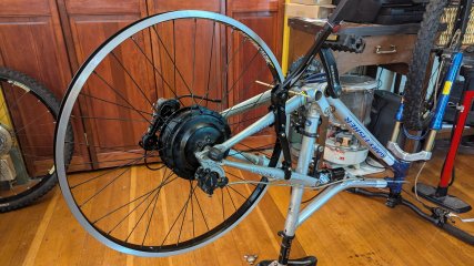

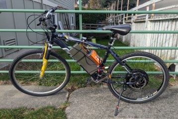

My before picture starts with a wheel build.:
The motor is rated as a 36v 500w direct drive, and cost me $79.
I hooked it up to this battery, after adding a 30a bms. I bought several of these packs from battery hookup, back when I was going to electrify my Grom. I bought a Ryvid Outset when the price got low enough. So, I'll count it as free.
I used this $50 controller, I believe it's for a motor scooter. I wanted to see if it did regen braking. It does!
It's all now on this bike, built from free bike parts. Between the motor wheel build and the controller I have $200 into this thing:
Kinda crappy looking, but it actually works great. I'll probably install a conventional ebike controller and battery at some point, but this was built to be the test mule for a supplemental super capacitor bank installation. I have close to 200 38F not so super super capacitors, and didn't want to burn-up my good ebikes.

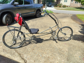

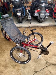

I've converted 3 bikes so far, all to mid drives, all are recumbents. I'm all about neat installations and keeping the bike looking as normal as possible so I do my best to bundle wires and route them as close to the frame as possible.
First was a Greenspeed Magnum trike, I put a Tongsheng tsdz2b 48V motor and a battery on a custom mount. Later on I added a SRAM 3 speed internal rear hub on a new wheel to give the bike a bit more top end. I also put a larger chainring on the motor for speed.
The next conversion was a Rans XP which is a long wheelbase bike. I ended up buying a bike that was converted by an 80 year old guy that was afraid to ride it. I got the bike for 350 which included a Bafang BBS02 and a 48v battery. The bike was a thrift store purchase that I pulled what I wanted and ditched the frame. I mounted the battery on a triple bob mount and the did a very low power tune on the motor so I would get some assistance but still do most of the work myself. The other thing with recumbents is that it is sometimes difficult to get going so you have to Fred Flintstone it a bit till you are moving fast enough to get your feet up. No issues with this bike since the throttle takes care of that. I eventually added fenders and it pretty much gets alternated with the Greenspeed for daily rides.

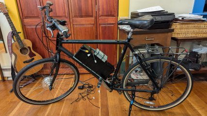

More of an inbetween picture of one of the two bikes I'm converting:
It's my first front hub motor bike conversion (outside of a motor wheel and rack mounted SLA battery that I used on this very bike in the mid-2000's.)
The battery is one of those 12s4p A123 battery packs with a new 30a bms installed. It's my second wheel build and I'm getting the ebike conversion thing done for less each time, and maybe it looks like it. But this thing will kick ass, that is until the motor burns up.
The weekend started in the fitting of a controller box to the front stem. I really want to build pretty, but the 7a KT controller wouldn't spin the wheel on throttle. WTF! This is my 6th build and I have never had that happen. Like, what am I going to do. Learn how to troubleshoot the controller?
As luck would have it, in the middle of this dilemma, amazon delivered (2) 11amp controllers. Something that I had ordered in a state of doom buying.
Hooked one up, motor spins!
So the thing sits like this until I get the soldering irons out. I'm planning on making a hood made of roofing rubber to fit over the controller and battery. That might work, or might not, but it's what's laying around.

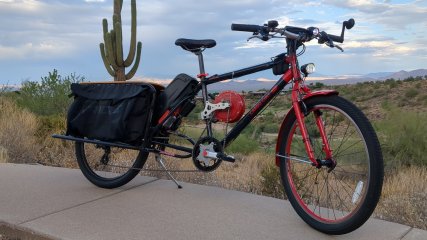

I posted more info about this bike a few months back when I completed it. Figured I'd add it to this before and after build for grins. Too bad I don't have a photo of the Trek 820 by itself. The nice folks at xtracycle dug up as many original decals as they could find and that helped me with restoring the xtracycle. Though I ended up making many of my own duplicate decals with decal sheets and laser printer. I sealed the nice note from they sent on the bottom of the FliteDeck. The Free Radical and Free Radical Leap are no longer made and xtracycle only sells e-cargo bikes these days. I find that kind of sad since those bikes sell for $3k-5K - which seems kind counter to the original ethos of affordable cargo bikes. But hey, the market is what it is and you do what you must to survive. Their new bikes look like they are decent bikes. But I still like rolling my own.
More details here:

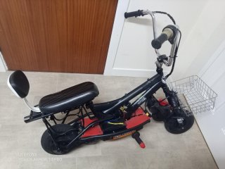

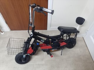

I'm not going to lie, I bought a Mini Rocker for my kids, thought it was cool so bought one for myself, then discovered how terribly unfit I have become and how hard it can be to pedal a bike that is small enough to shame a clown so I put a motor on it.
I usually lie and say I built it for the kids, but I built this one for me from the start.
