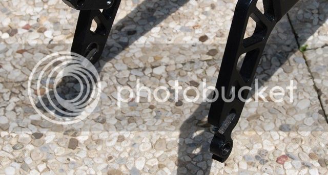

I also think it should have bolt/clamping dropouts even though they look really wide and strong

P.S.: Spare parts are available, 150 mm dropout also, your battery in 2 separate packs would probably fit (I attach the opening drawing).

Sure, 26''x3'' can fit on to swing arm without any problem. On the photo below you can see there's a 10cm spacing (tire on photo is 2.35'').
