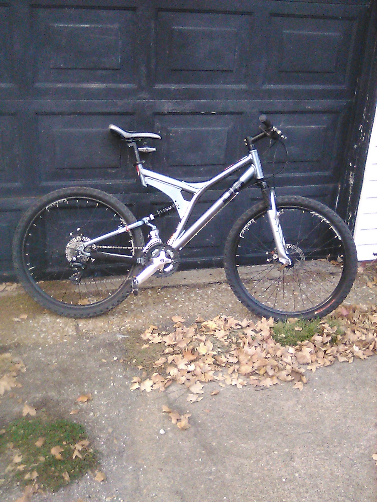

I have two light vehicles right now, an unmotorized Milan SL velomobile, and a custom-built electric velomobile on a KMX frame. There has been a small number of times where both were out of commission for brief periods, so I decided to add a third bike to my fleet.
I picked up a used Diamondback on craigslist, which will be receiving my old Phaserunner controller, 1.5kWh Li Ion pack, and Leafbike 1500W 4T motor that used to power my electric velomobile(which has since been upgraded to a 3T wind Leafbike, ASI BAC4000, and a 1.7kWh pack of Molicel P42A). I wanted dual suspension because the potholes around here suck. My expectations aren't high. I'm looking at running perhaps 2kW peak and will use 750W or so most of the time. This build will be much less ambitious than my first, and is going to serve as a back-up bike when all else fails.
I plan to make this able to cruise 25-30-ish mph, maybe top 40 mph(although it wouldn't be safe at speed), and it will probably only get a 40-50 mile range at cruising speed with a stock body.

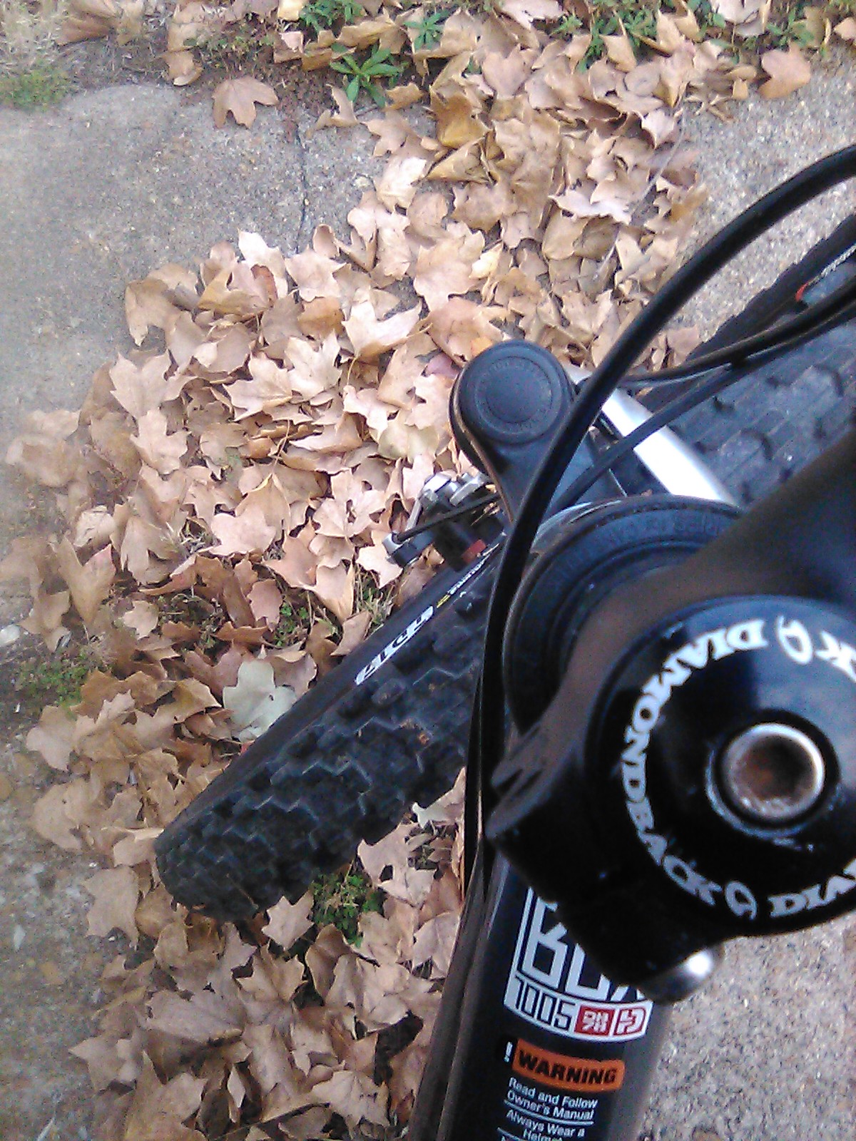

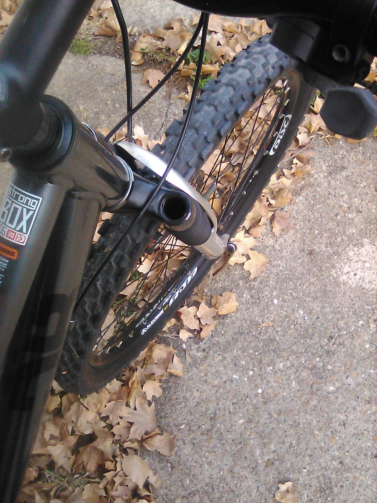

This all said, it appears that my right-side front shock is missing a plastic boot. Does anyone know what they are called and where I can order a replacement? I'd like to keep the rain out.
They're basically just plastic caps; sometimes those for the ends of furniture tubing will fit, and since the tubes on all these cheap forks are typically the same diameter you can pop one off any similar "suspension" fork and try it. If you can find a big enough bottle cork you can use that if you don't mind the weird look.
I have a similar DB MTB. Mine is a DBR XR4. I assume the DBR means Diamond Back Race. Mine is identical to this one:
Haven't decided what to do with it yet. I primarily purchased it for the components as It looks in good to excellent condition, but may just clean & tune it for one of the G-kids. - Dunno yet
I had one of those many years ago; it was light weight and fantastic, so it should be enjoyable however you use it.
I rode it back home after purchase. I've never ridden a full suspension mountain bike before, and this was the smoothest upright bike I've ever ridden. I've ridden a lot of uncomfortable punishment devices called road bikes though.
This new(to me) mountain bike still isn't nearly as comfortable as either of my velos, but its smoothness on the roads falls somewhere between the Milan SL and my custom build, the latter soaking up potholes better than many cars I've ridden in.
My main concern with the mountainbike is the durability of its components, more than comfort. Comfort is more than adequate. Will the parts hold up to doing 25 mph on pothole-laden city streets? I will be finding out in the coming months, and hopefully not the hard way.

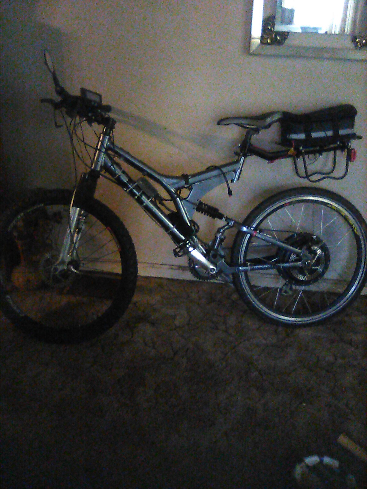

Today I got my old 4T wind Leafbike motor apart. I needed to make some wiring repairs. The regen use in the trike did damage some phase wire insulation early on when it rocked back and forth in the dropouts and I lost the original cassette-side axle nut. I rode it for nearly 2 years like that and decided to repair it before reusing it. I will be ordering some torque arms and possibly have everything installed before the year is over. Compared to the electric velomobile, this build is quick and simple.

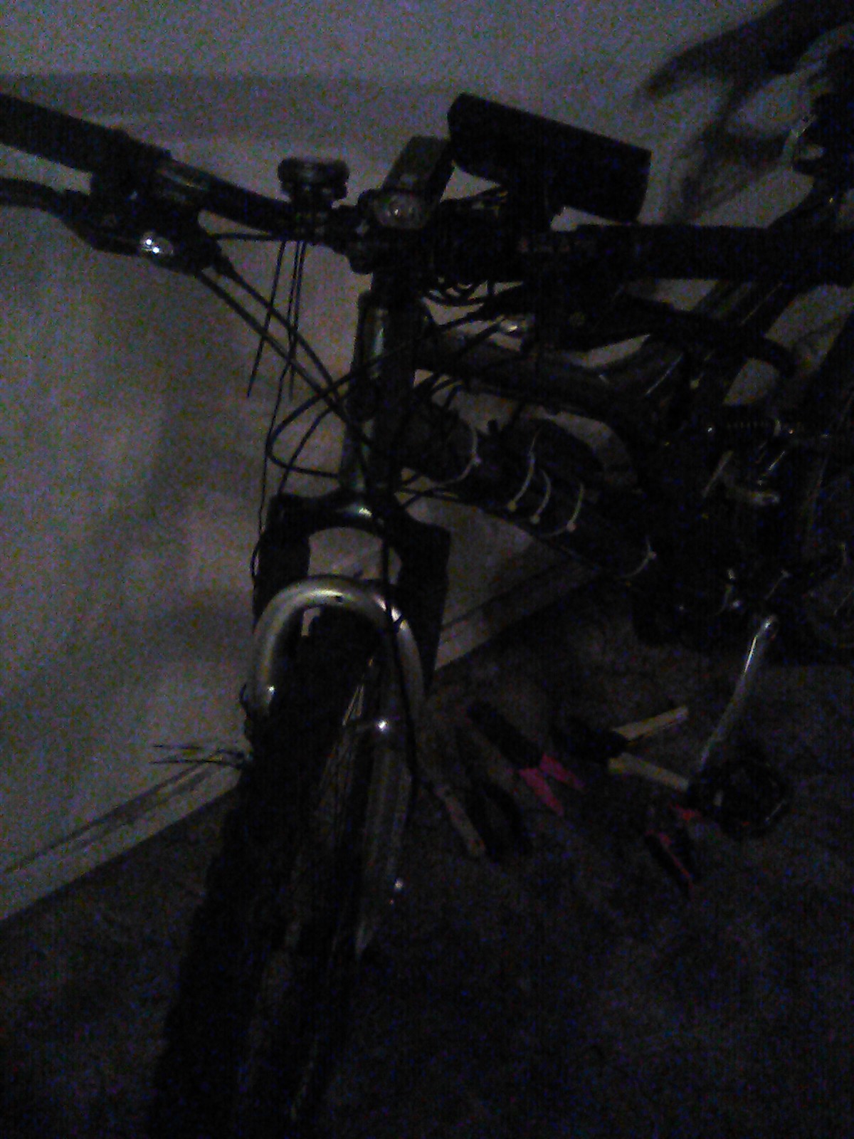

I now have everything installed. I'm about to wire everything up and program the CA3. Maybe go for a ride sometime today.
I had to perform a headset adjustment(first time I ever did so on a bike).
The pedal crank bolts were seized into place. No grease was applied by the manufacturer. Getting them out took hours. I had to be careful not to strip the plastic hex key inserts.
The bottom bracket was seized into place and the non-drive side cup was made of plastic which was heavily degraded and broke upon my attempt to remove it. Getting the existing bottom bracket apart was an 8 hour ordeal, but it was necessary to put the torque sensor in.

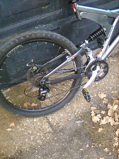

The electric motor did not want to cooperate going into the dropouts. Part of the issue was the rear brake. It now rubs and I need to add washers to space it out a bit. The rear brake rotor did not want to leave the rear wheel it came off of, and getting it off was a massive ordeal that stripped a steel hex key insert.
I was only able to use one of my 46.8V 15.6 AH Greenway packs. The panniers I ordered did not fit. I went with a seat-post mount rack to mount a single battery pack instead of both in parallel.
In all, I'm going to start with 750W, and maybe bump that up to 1500W on this single battery pack.
I'll be lucky to get a 20 mile range at 30 mph.

It now works.

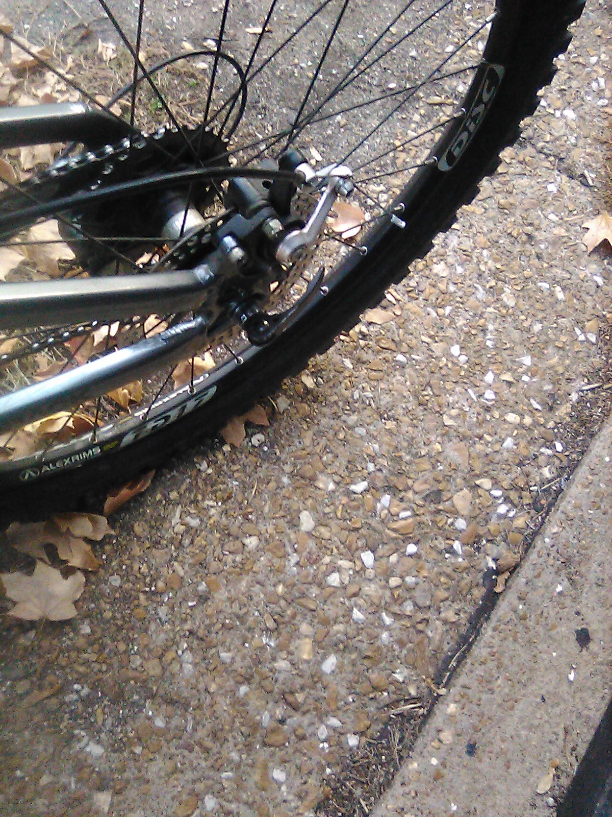

I might have to delete the rear disc brake caliper though. The spare Avid BB7 I have does not fit with the mounting point on this bike, and the caliper it came with has a fixed location semimetallic pad on the left side which slightly rubs on the rotor. There isn't much I can do about this given the position of the Leafbike motor. I'm going to have light regen in the rear anyway.
Another possibility is I just lathe away part of the pad while riding the bike until the rotor clears.
In any event, I need to do some research to find brake calipers that will fit this frame and upgrade. The calipers that are on it are kind of crap.
I also need to find some kind of on/off switch. I'm using the battery plug for that at the moment.
I wouldn't trust your seat post with that battery(?) hanging off the back.
I don't trust it either. It's a temporary measure. The cheap rack is rated for 20 lbs. I have a 9.5 lb battery on it at the moment.
I'm eventually going to spot weld a custom 72V/2kW/750Wh-ish battery to fit into the tiny triangle part of the frame and move the Phaserunner to the top tube up at the front.
Sorry can't quite tell from the grainy photo but I solved my rear caliper interference by installing a 203mm rotor and appropriate caliper mount adapter.
