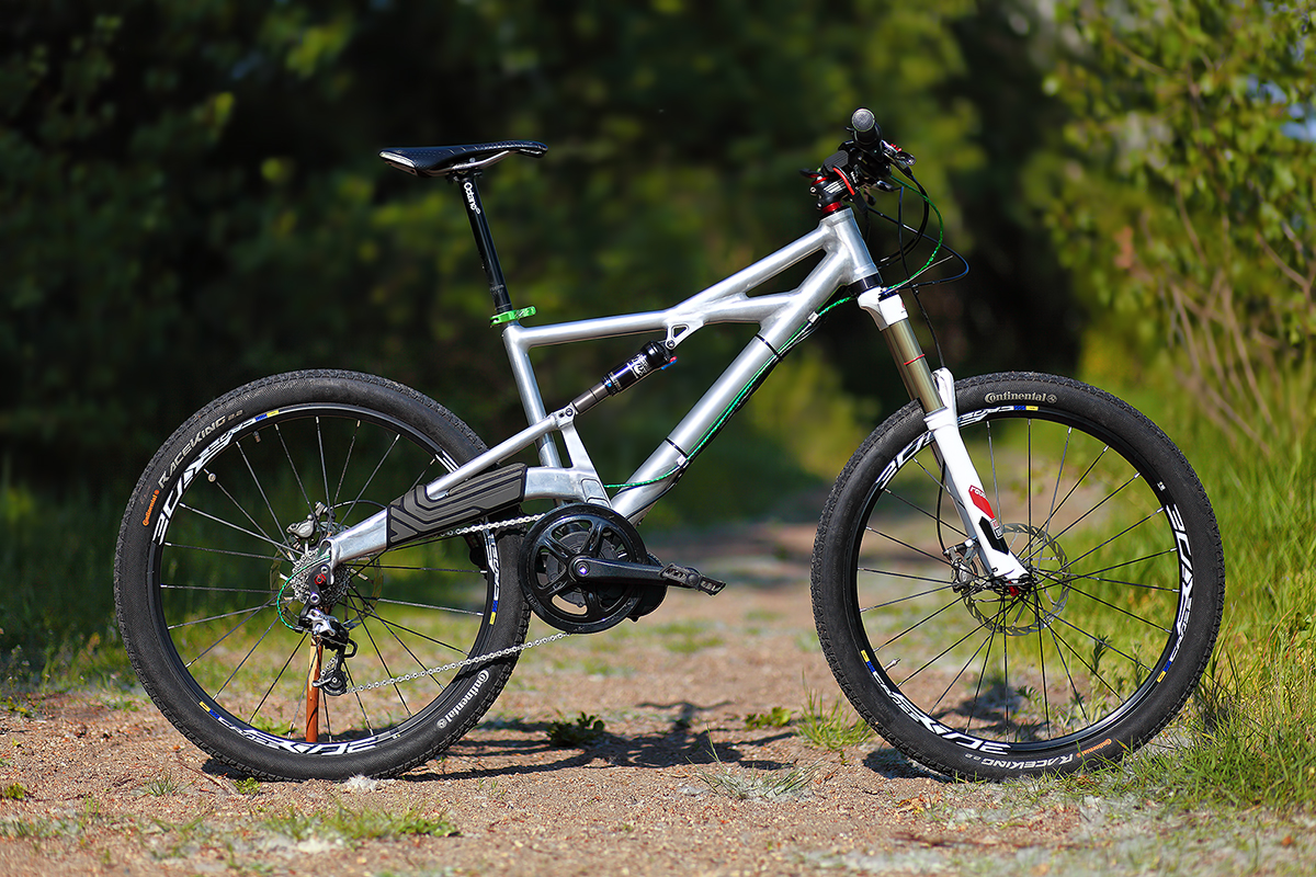

Quite a Year ago i did my first Ebike build.
I converted a Cannondale Prophet with a bbs01 18A-36V.
Im still quite happy with it, but the wish for the raptor was there, since i saw it the first time.

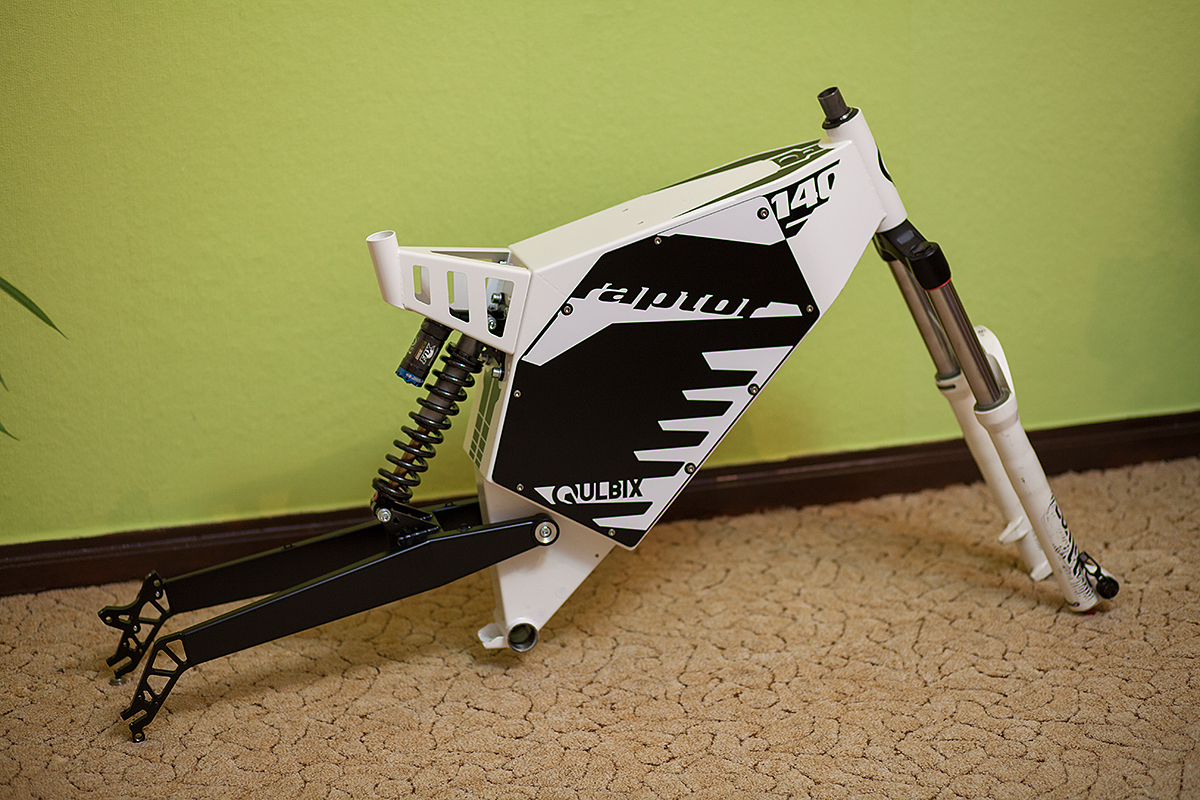

I opened this thread for 2 reasons, first to share the build process to others which are interested and to avoid getting the wrong setup, parts and so on.
I ordered the framekit with the 165mm swingarm to have all options.
More pictures when the framekit arrives......
I have to measure if its possible to stick with the A123 20Ah pouch cells.
I would like to use a batterypack that will last at least for 5 to 10 years, so Lipo is not an Option.
Also the discharge curve of LiMn, like the konion, is not an option, therefore i hope i can stick with the a123 pouches.
I really dont know where i will go exactly.....there are so many options.
The main importance would be efficiency, i dont need to go faster than 65kmh.
Therefor i plan to stick with an Adaptto mini-e.
I really want to go with the 4t cro, cause i think that copperfill and the wide stator will benefit my consumption.
On the other way a lighter MXUS 5 or 6t, can be fed with more voltage.
On a cro i would go for max. 20s LiFePo4 to reach my ~65 @24 inch bicycle wheel.
A TC65 would also be an option.
Bad news from the battery battlefield, the 20A A123 pouches will not fit.
The 14A will do the job perfect, 2 packs 20s (20s2p) will fit barely side by side but............they are not available, or i am unable to find a seller. :|
So back to start with the battery. :(
The fork isnt the one i will use, just for the pics.....

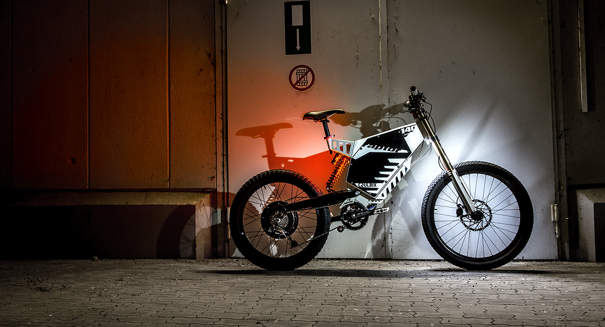

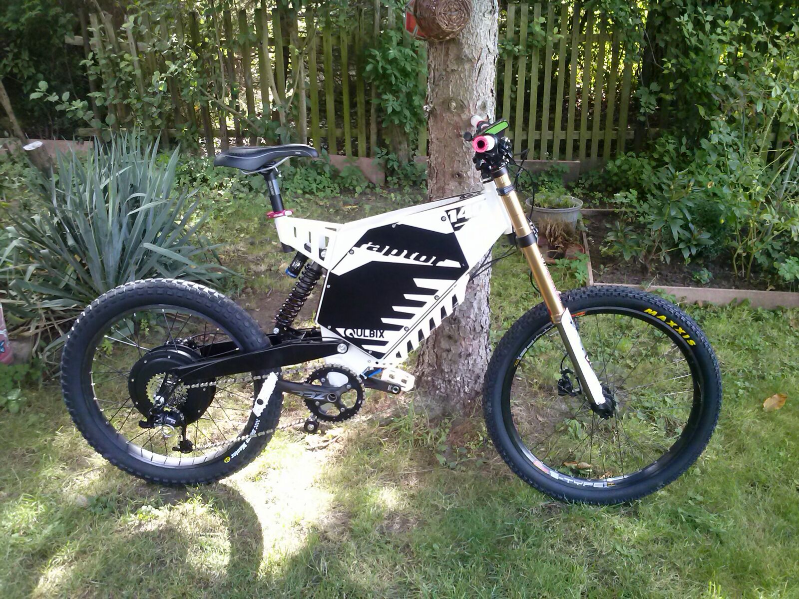

Yes i loved your black/white raptor, so i wanted the same framecolor as yours.
The chain tensioner is some random one, that used to live in my big box with bikeparts which i collected over the years.
I just took my dremel and extend the long hole, so i can use the full lenght.
It is one to clamp it under the bb.
I just took some rides, i definately need to install a chainguide on the upper side too, i lost the chain on every larger bump.
I will provide better pictures after or during the weekend, the raptor is at my parents place, but my dslr is at my home.
I just drilled the holes for the controller a little bit nearer to the hole, but you can do what you want, you wont get all cables in.
I just got the + and - in and one connector......BMS i guess.
It may look clean on the crappy pic, but the whole cablehorror is held together by plenty of cable ties.
I will provide you with better pics then, also the chainline.
Its not final so far, i just wanted to ride this sucker.
I went for a 20s 19p battery of r25 and also took a MXUS instead of a QS....maybe later.
First couple km are done and for NOW the power is ok for me......im at 60A battery and 120 phase.....accelerates very good.
I guess i dont need more, but ask me again in 500km. :D

The bafang is a complete other story.
I cant decide which bike is better.
Surely the Raptor is more a motorcycle than a bike.
You can go fast, with plenty of power, accelerate without shifting, but the cannondale with the bafang is a lightweight and simple bike and you can climb slow and cool with it.
The raptor also is way more complex.
When i have a flat tire with the bafang its a story of 10mins.
With the raptor the worts case scenario. ......
I guess i like the raptor more, cause it generates more fun, but the other is good also.
