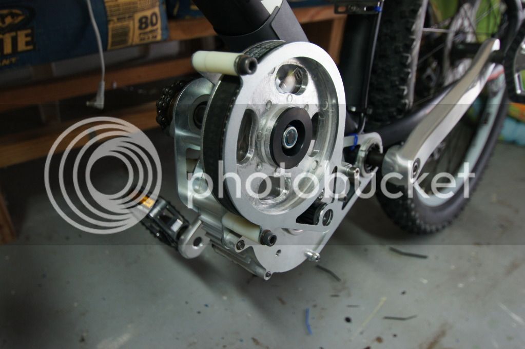

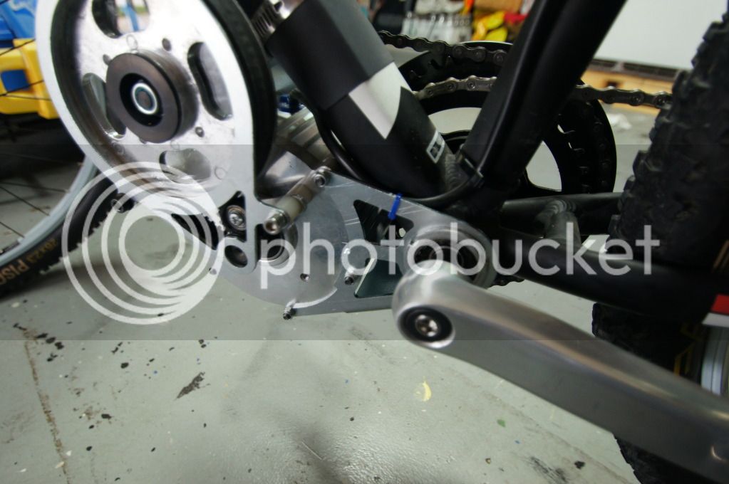

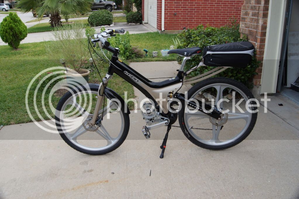

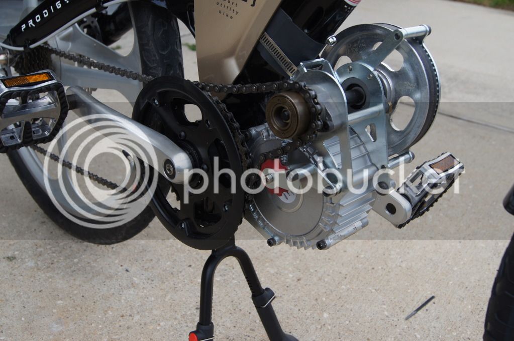

I build me a center drive ebike with a GNG kit with 12s1p lipo. The kit needed some tweaking and got it to work. Found me a Giant Prodigy frame on ebay and started from there. Well the bike is nice and light, but can't handle the torque the motor/gearing setup produces. The rear of the frame just twist under load. Bummer that after all that work, I will have to take it apart again and set it up with as something different. So I stuck it in a Hard tail Fuji bike. I'm going to use Lyen 6fet mini monster, Left hand throttle, 3 speed switch, with 14s1p lipo.

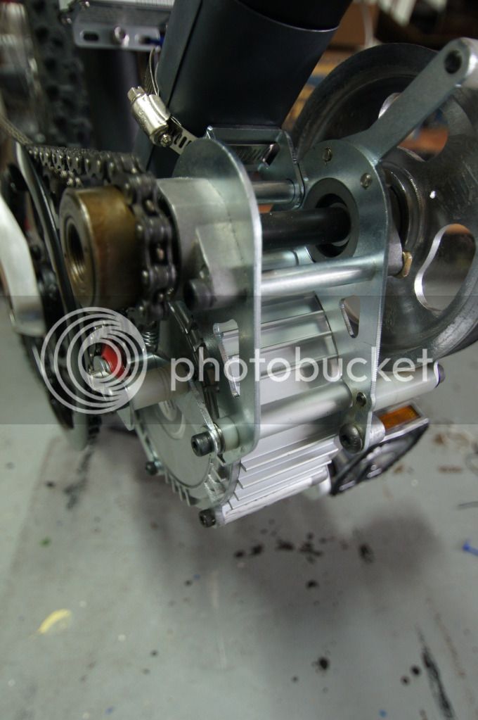

Replaced some of the metal spacers with Nylon ones. The spring on the idler is tighten up a bit, adding some tension to it. I'll add some threat locker too. Got to see what other screws I can find at the Ace hardware store. Still need to finished wiring it up and adding the CA. Installed a Connex 9 speed chain, hoping I won't snap like the chain on the Prodigy.

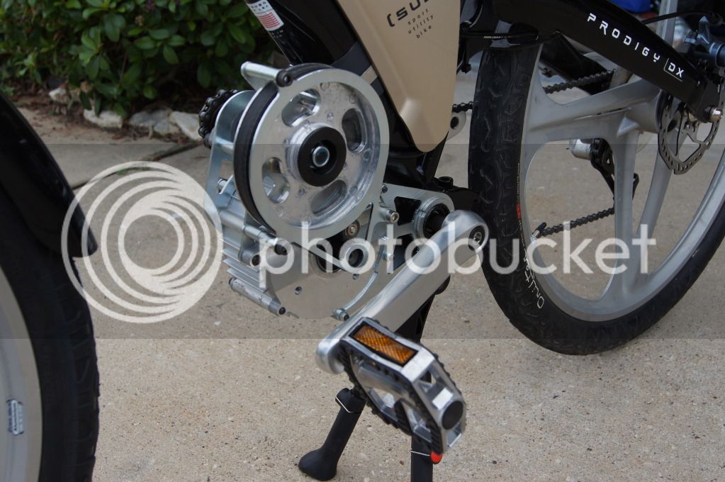

Pics of the Prodigy, which now back to a regular bike which the wife uses.
Here's the Fuji Nevada 1.0 hard tail.

I'm going to install a chain guide on mine. Chain fell today on the trails and its a good thing I have the connex chain with the easy removable link. I need more amperage and gonna try to run this motor sensorless one of these days. I have no issues with my chain idler and stock spring. Just added tension to the spring and it's still holding up. Belt is still ok, but have a Goodyear belt as back up just to be save. MTB trail was busy today and had quite a few that was asking questions about the setup. One dude even rode it around a bit and was impressed with running it through soft sand.

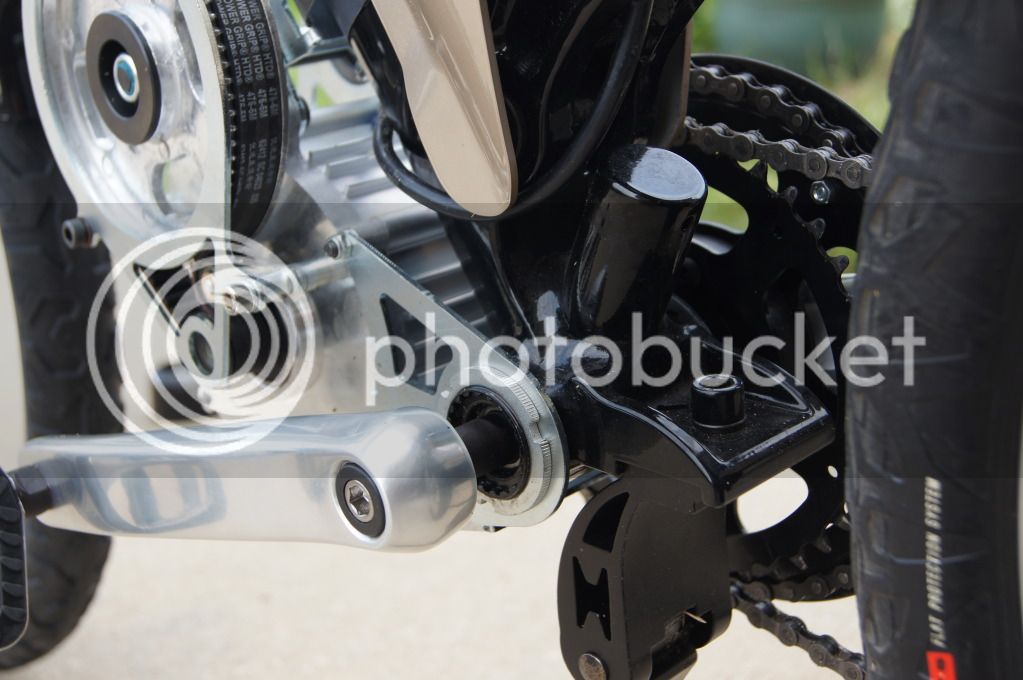

Hi Snelleman, the flex issues you had on the prodigy-are they related to the swing arm on the suspension unit and distortion of the chain line? I am looking for a s/h full suspension bike for the GNG unit and want to know what to avoid. cheers hech.
Hi Gorach. The swing arm on the Prodigy really flexed under load due to the design of it. I didn't install it on my other full suspension bike too see if I still would have the same issues.

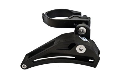

I bought me a Origin8 Torqlite UL Chain Guide - 31.8/34.9mm Clamp and an Ebay chain tensioner. I'll see how they will work out.
Any chance you could post photos, cost, source, after you mount these? Mine works but it's not very pretty.
