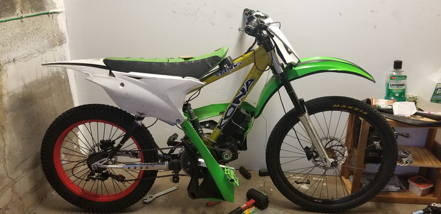

Kona Stinky frame
Cyclone 3000w motor
72v 50 amp 20ah battery
72v 50a controller
Full motocross body kit and seat
7 speed freewheel but using bigger gears only, you reach top speed in 4th gear anyway.
I'm amazed at how cheapie 7 speed chain has been holding up
This thing ripped.
As long as your deraileur is adjusted correctly and your primary chain is always tensioned, regular bicycle drive train can really take some abuse. I also run my pedal chain shorter than normal for best tension
Never had a pedal chain snap, only primary motor chains and those were only times when the chain tensioner became loose and no longer held the chain on tight. I have had chainring bolts explode on the other hand. Replace those with solid bolts and your good.

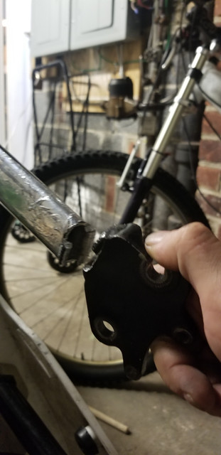

Then one day something broke... out of all things, the brake mount side of the swing arm. Happened while tapping the brakes during a very slow wheelie with little force.
Broke off clean at the welds. Frame is from 01-03 so who knows...
They say if it ain't broke dont fix it... well its broke so let's fix it and also try to make it better... first rule broken dremeling off the other side of the swing arm...
We'll just chop this piece off of this steel swing arm, which attaches similarly to the seat stay the same way the kona does.. originally a circular tube and hammered down to ovalize and shim inside the kona..
Like a glove
Now let's start breaking more rules... drilling holes into the steel swing arm first..
Then into the aluminum swing arm
Slow and steady wins the race... trying not to heat up the swing arm too much or stress the area with too much pressure
They literally thread in
A bunch of nuts, bolts, washers, and spacers later...
Took the bike from a 44 inch to a 49 inch wheelbase
Now let's throw on a moto tire for that back wheel just because
And brace this back brake mount so no more brakes brake.. test mounting brace to be welded... seems legit
Weld and paint
Extending the swing arm by 5 inches and extra weight from moto rim/tire really ate away at that instant wheelie torque you normally get from a cyclone... so I shortened the swing arm down to 47 inches and shunt modded the controller to get some snap back... now this thing really rips.
I preloaded the rear shock a bunch of turns since extending the swing arm adds more travel and therefore more leverage on the shock... I wonder how much travel I gained by adding 3 inches of wheelbase?
I've ran this through some pretty knarley terrain and it holds up nice and stiff... rides over rough stuff like a cloud. Even taken some small jumps and hops here and there at speeds and no signs of stress. I honestly ride it like it never broke and it doesnt seem to be showing any signs of weakness or worrying flex even with the (so far) full power of this mid drive running through it
Oh yeah, I got tired of worrying about heat so I force air cooled the motor. Even though the cyclone has a thermal fuse which would disconnect the halls and make the motor error out in the event of it overheating, it was getting hotter by hand than I liked. So I made some holes and glued some tubes.
Now it gets warm at best no matter how hard I run it.. now its ready for more power... but maybe we should change those planetary gears out to steel first? Maybe lets see just how much the plastics hold up to first..
Thoughts? Much more to come...
