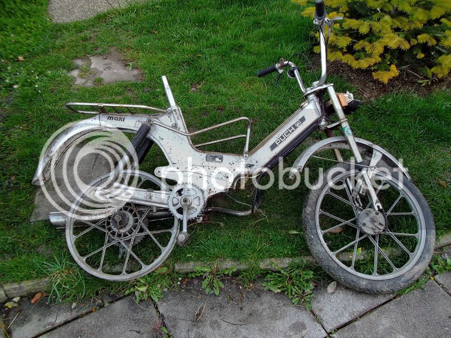

My father brought my a rusty and dirty frame, as a present from his chief to me. This was motivation enough for me to create a nice bike

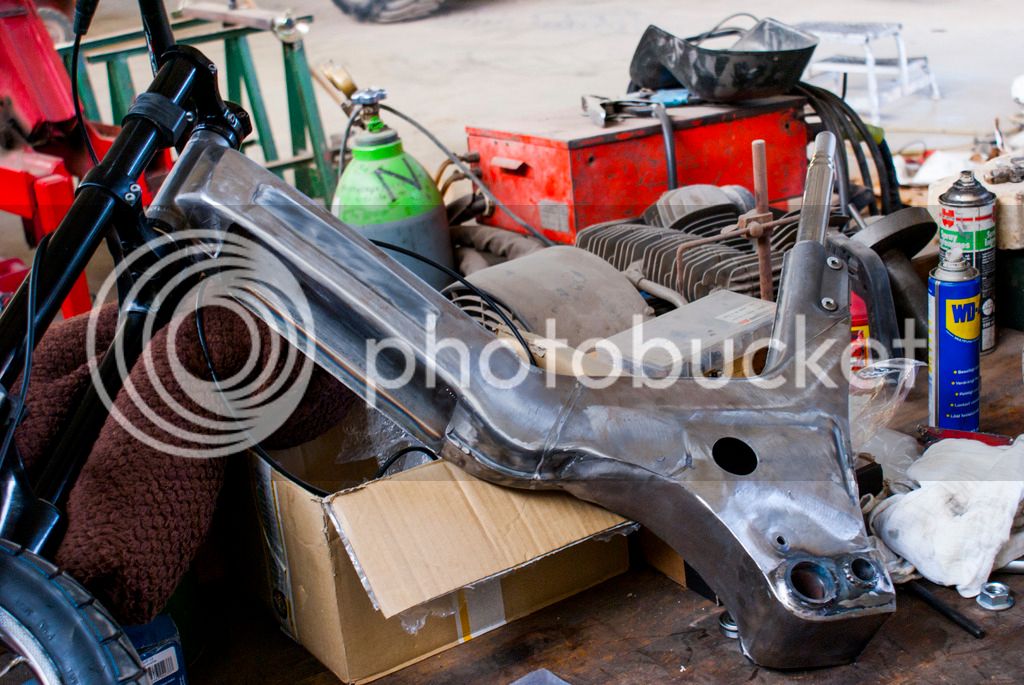

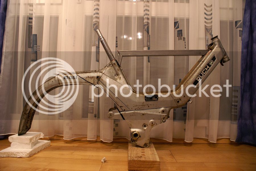

I threw away all the redundant parts and cleaned up the frame. the first things I was thinking about ... Where can I place the battery? Well the bike has a gas tank on the front side of the frame, which is integrated in the whole mechanical construction. removing or opening this would decrease the mechanical strength of the frame...So I am place the battery pack between the steering head bearing and the socket for the seat.

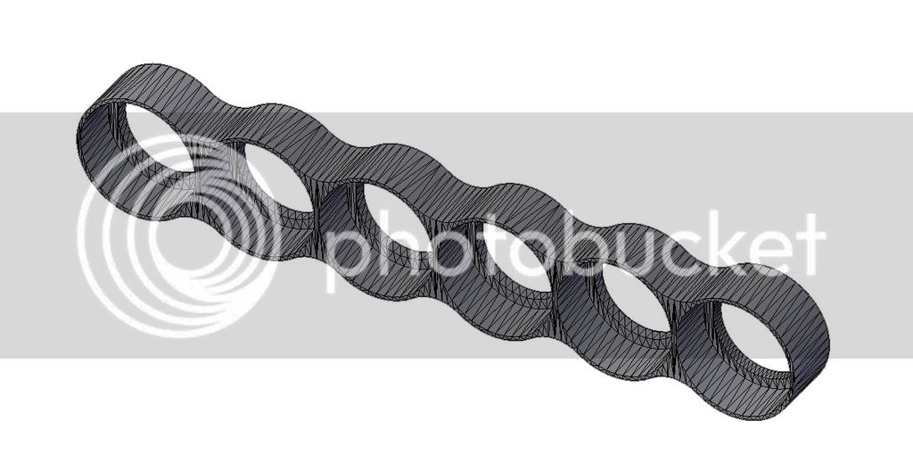

The next steps was to plan the design of my Headway pack. I use the single cells in a row, as you can see. The plastic holder are build by a 3D-Printer.
In the meantime I got to know a nice guy, which supports me with all the mechanical / welding work, so we cleaned the frame to a delight version

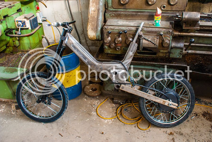

So the frame got a second axle for the bike crank. The front suspension is a Marzocchi
888 VF2 with the 20mm axle. A good friend of mine mounted the tires on the rims and fitted the cromotor. My spokes are 4mm thick, so at the back I use a 17" rim (1.80") and at the front a 17"(1.20") with Sawa Sport tyres
Well after getting the frame and tyres ready, we started with the lever out of wood for checking the poition of the seat and so on...
The lever consists of a very robust aluminium profile which is welded with very strong drop outs for the Cromonster.
I hardly found the perfect fork for our frame, so we used a scooter fork with an extra gas bottle where you can choose the strength of the bumper.
