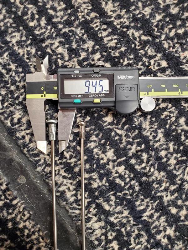

My rim holes are about 6.87mm in diamter.
My Holmes Hobbies steel nipples are 9.45 mm in diameter.
I'm not sure if 8mm will be enough for a 7mm hole? If those are really brass nipples then I would pay the price.
Then the other question is what is the diameter of the 12 gauge nipples that the Sur-Ron 18" moped rim uses? Because I will have those nipples to use?
The 18" x 1.6" Rim I will be using
Holmes hobbies steel nipple on a 12 gauge spoke next to a normal brass 12 gauge nipple.

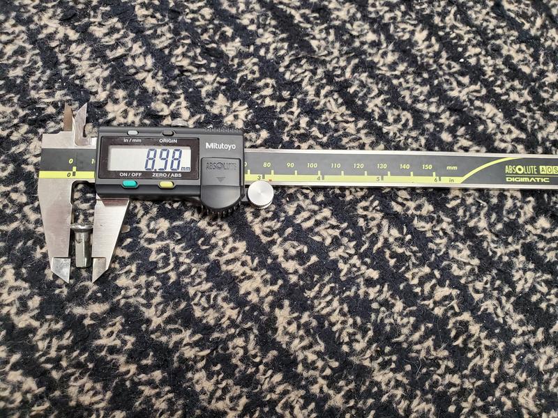

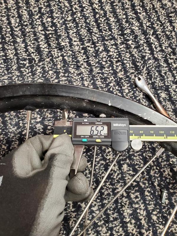

OK, I bought the Sur-Ron wheel set so I have 2 new rims to use for the Sur-Ron. That means I will take apart my original rim to use for this 18" build. This is because I need the hub.
I removed my Sur-Ron rear wheel and removed one of the nipples. They are steel. But the head measures 9mm and they work perfectly with my 18" rim.
The holes on the Sur-Ron rim are about 6.5 mm.
I'm good to go with these, there is no reason at this point to buy other nipples. The Sur-Ron steel nipples never gave me issues or pulled out. I guess I will have to use some never seize on the spokes? I remember using that in the past as that was recommended to use for spoke prep.
This is a steel 12 gauge Sur-Ron nipple.
This is the hole diameter of the Sur-Ron 19x1.4 rim.
