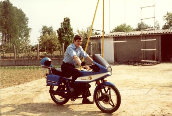

Need to get my hands on this fairing! this is a highly modified mb5.. probably done in the early 90s.
