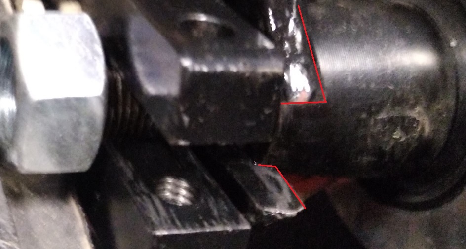

In the second to last pic, the spacer looks like it has a notch in it, but why is that there? It looks like the spacer OD is barely larger than the slot/opening for the axle and most spacers are flanged at the swingarm side to deal with that. Have you had any problems with that spacer trying to wear its way into the swingarm?
I apologize, but I'm not sure what you're describing in the picture. It certainly doesn't help that the pic I took was dark and out of focus. I guess to answer your question, no, I have had zero issues with this hub motor/torque arm alignment, it's one of the parts of this build that I've been most pleased about.

Sorry, I'm a bozo! I looked again and it's just the tail end of the swingarm itself. For some reason last night (no drinks I swear) it looked like there was a notch in the spacer, think it's because I was looking at it zoomed in. I added some red lines to illustrate. Top lines had me thinking it was notched, but the bottom line had me wondering if the spacer was digging in to the swingarm.
This is correct, I know it's hard to see, but yeah, it's the rear end of the swingarm, which itself typically has to be cut to allow the hub motor to slide in
