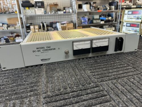

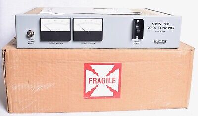

So I'll ask the forum once again. Does anybody know of a better way to charge my 116.8v motorcycle from my 48v nominal house battery, in the range of 1000-2000w?
Could several of these be put in parallel?
I'll take a look at this model and other similar, hadn't seen this one yet. Thanks!
