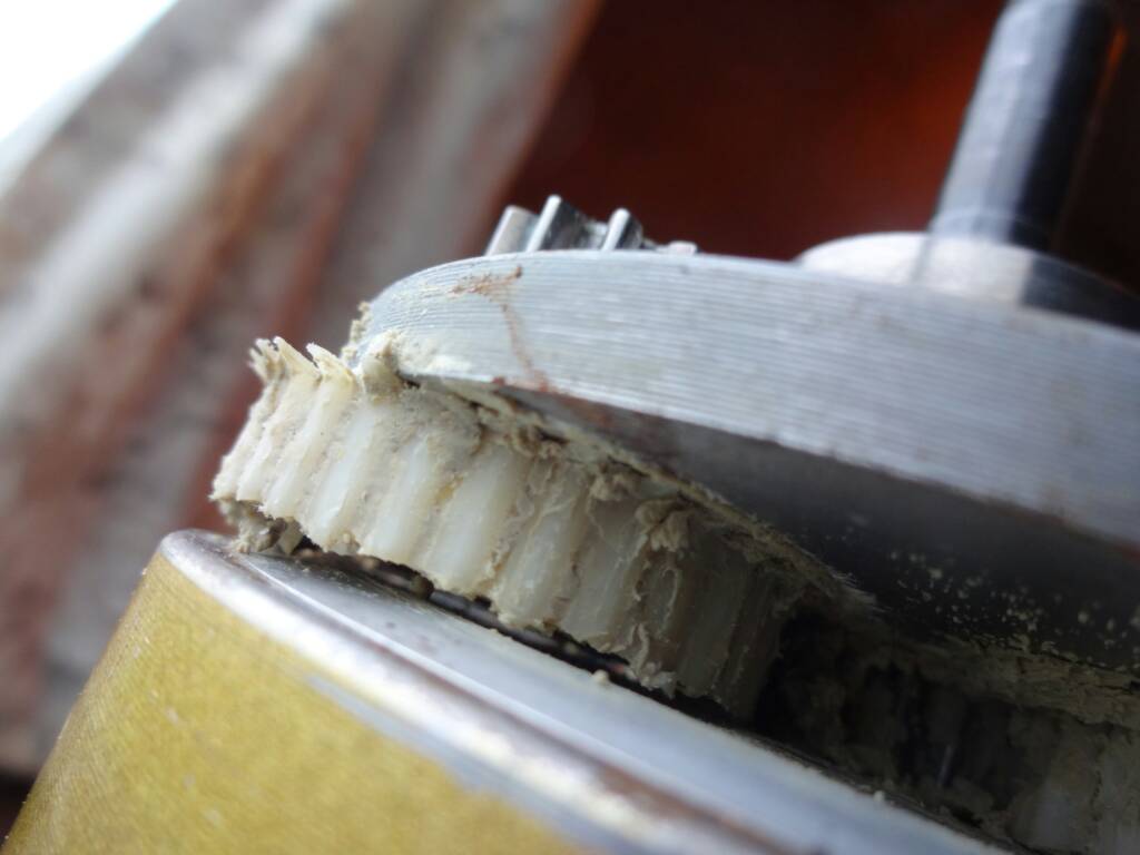

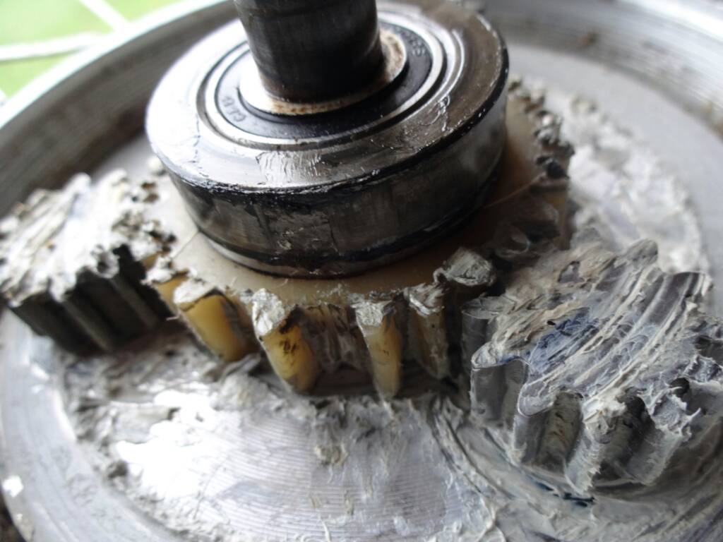

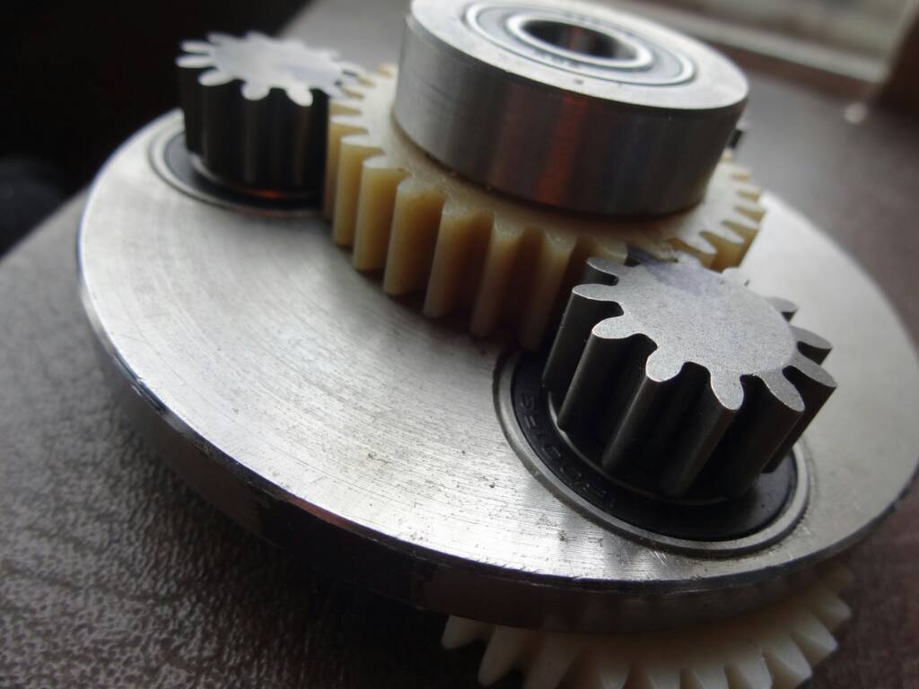

Yiihaa my ring gear has arrived.
Bonnie at xiongda is just marvelous.
What type of grease are you going for.I'am on 1194 miles now think it's time to put some in.Having a uncontrollable urge to use one of these.skoleskibe said:Yiihaa my ring gear has arrived.

1boris said:I think the q128H 800w (inrunner) is a much better motor.Small,quiet,very powerfull and takes a lot to get hot.I used this motor on the same hill I burned the xiongda half way up and it was only hand warm at the top even when I run it with 48v 18 ah.But the lcd3 display shows only 800w max when battery is fully charged.Top speed on the flat throttle only is about 43-44 kmh.It is listed as a 201 rpm at 36v,but that cant be correct.and I could pedal faster up the hill then with the xiongda.Another thing I noticed with my Xiongda motors is that the torque is significantly weaker when the motor is warm(not hot) but also the controller gets very warm.

tcusack said:Hi Menvert.
Two questions: You have perservered with these motors, while others have fallen away. How have you dealt with/worked around the reluctance to back up, and the apparent eventual damage to nylon gears?
Is the Q128H marked as other than 250w/350w, to your knowledge, and how is it marked? I'm interested in a Q128H for my first build, because, all things considered, it looks to have greater long term reliability than the XD, and similar real world climbing ability.
