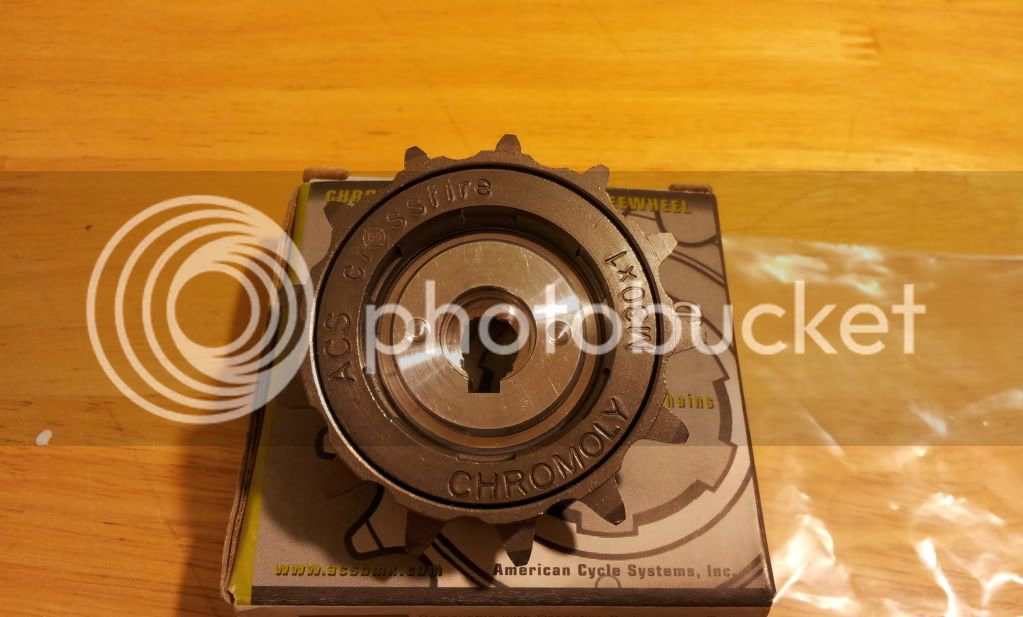

My freewheel just came in today. I hope everything lines up right. There may be some clearance issues with the adapter and new freewheel. The Chain line from motor to large crank chainring may change as well. Unfortunately, since the last part to make this all work showed up today, things will have to wait until Sunday (Working from tomorrow until Saturday).

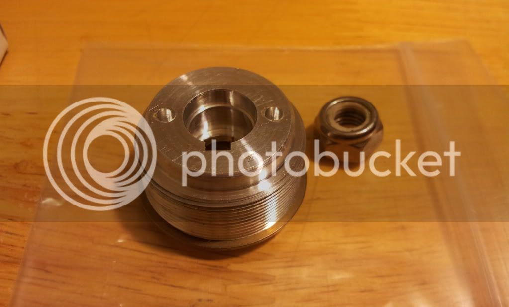

Here are some pictures of the jackshaft adapter and the ACS Crossfire 13T Freewheel:
I would have liked instead of having a groove machined in for that retaining ring that there was just a lock ring and a spanner wrench.

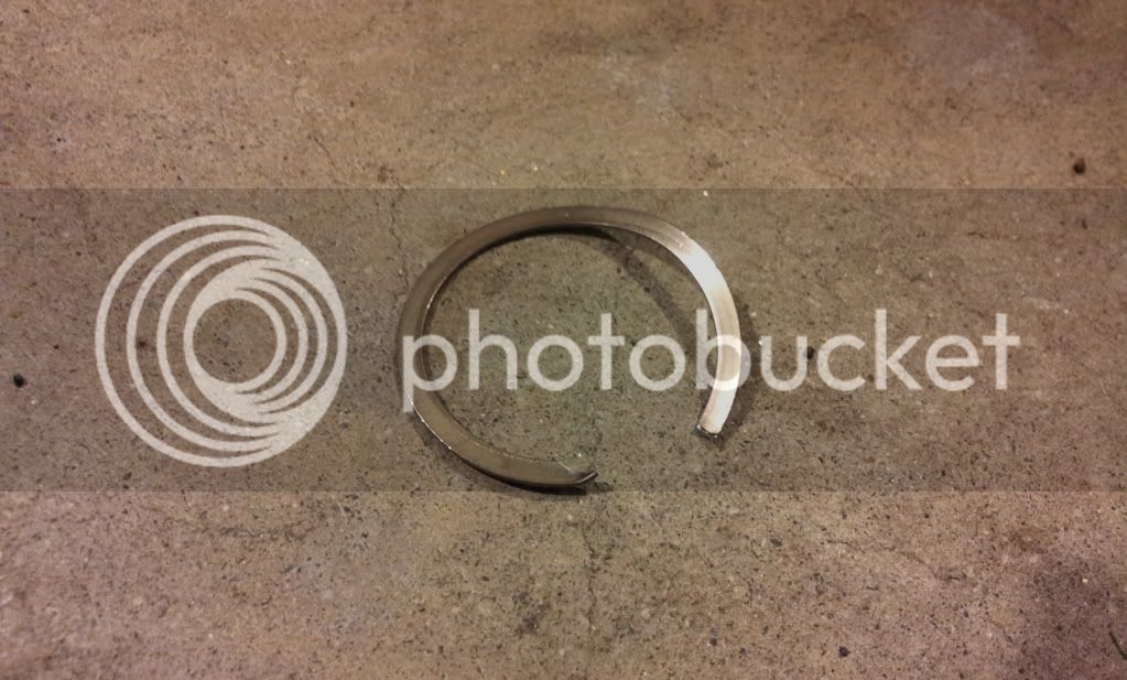

I trimmed off the excess with a pair of dykes, and the rest of the ring is most likely wedged properly stopping the freewheel from twisting off. However, the chain line did change as a result, and I'm not a fan of losing half of the freewheel retaining ring.

That's the BikeMotive with the ACS CrossFire 13T freewheel. (Keep in mind, if you're going to go with a 13T, you'll probably have to use a half link as I did.)

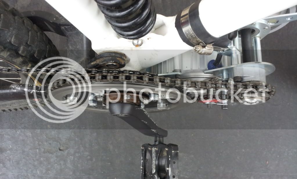

Adapter mounted and spacing before the retaining ring started to peel. I bought some spare bushing spacers to adjust the chain line if need be, but I found it lining up the best with it as far on as possible bringing the chain closer to the bike.
Here's the sickbikeparts.com 48T chainring mounted to my 34T Blackspire chain ring(Thought it was a a 32T before cleaning it off) and sickbikeparts.com standard freewheel. It spins true in the forward direction and under motor and pedal power! :D
I had to get a new chain, due to the increased length and a half link (not a fan of this) to get it to work.

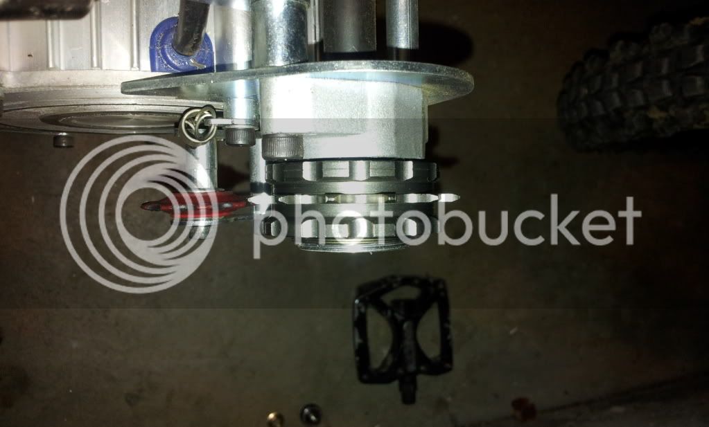

I decided to test the jackshaft freewheel adapter to see if the remaining pieces of the retaining ring would hold. After hitting my 44v LVC, it's managing to hold under full throttle in any gear as well as abrupt throttling. Here are the post pictures:
That's the part of the retaining ring that was coming off in the first picture of my previous post.
The remaining part of the retaining ring doing its job.
The chain line is now the same as the GNG 12T jackshaft freewheel.

You can use a bottom bracket lock ring from an old 3 piece bottom bracket to lock the freewheel on the adapter. They are the same thread as a standard freewheel. Make sure you use one with the same thread though, left or right hand.

The 13t freewheel uses a smaller 30mm dia thread.

This came with my jackshaft freewheel adapter. Don't forget to pick up a half link if you go with a 13T freewheel.
fullthrottle... I missed the 13t bit of the freewheel. Yup, smaller diameter, but could work if you went up to an 14t.

Well, that jackshaft freewheel adapter seems be very stubborn. I'm trying to take off the ACS Crossfire using the proper tools, but it just seems fused on. Regardless of using a vice and a bolt/nut & washers to hold the tools on, it's impossible to get the required torque to keep the Park Tool SPA-2 on the freewheel adapter. It's popped out a couple of times starting to create a ramp on the two holes on the adapter. My big bertha flat tip screw driver fits well in the key indent, but I can't secure the handle or get enough torque twisting that or twisting it in conjunction with the SPA-2. I'm going to try an impact gun as a last resort. Also, BikeMotive has not gotten back to me regarding replacing the retaining ring. I may have just wasted about $70 trying to find a jackshaft freewheel replacement solution.
This adapter is probably still good for those looking to replace their 12T jackshaft freewheel. Just gotta do something about that retaining ring. Maybe get it more snug before applying motor power or getting some sort of snap ring or a M30 jam nut to work in conjunction with it.

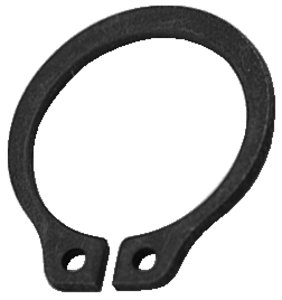

As for my jackshaft adapter, I think I've found a suitable replacement for the retaining ring:
http://www.fastenal.com/web/products/detail.ex?sku=1135326
The groove is 1.5mm thick, so this should fit nicely. I'll stop by a local distributor on Tuesday.

Anyhow, here are some pictures of the Fastenal 30mm snap ring:
It came out to $2.07 at the local Fastenal distributor for 3 snap rings.
Yesterday I decided to do a test run on the North West part of Fullerton Loop (where all the fun hills and jumps are :D ). It started raining on me about a 1/4 way in, but I was able to get through it before it got muddy.
The 30mm snap ring is holding great on the jackshaft freewheel adapter, and the ACS Crossfire 13T is super smooth. I guess the one downside is that the racheting clicks are spaced closer together. It's not louder, but the clicks/ticking sound from the 13T freewheel is more rapid if you get the idea.
