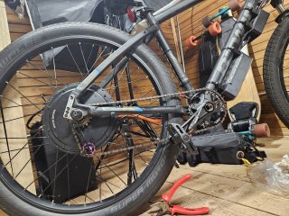

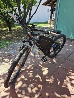

72V 8kW Rockrider with MXUS 3K Turbo and VESC Controller

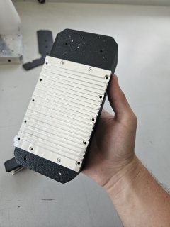

The one I have for the bike is the FLIPSKY 75200 Pro V2.0, which has a 150A rating at 75V. I was not sure if this was battery current or phase current, so I sent them an email to check. They said it's the motor current, which I though is a bit low. So, I totally ignored the warning and bumped it up to 250A phase, and after an hour of riding, the controller doesn't even hit 40C, so I bet you could push it even more. I'm currently running 8000W peaks and the controller handles it fine...

I had a ND72680 in my 180kg heavy scooter, the Fardriver can output up to 680A phase current and over 300A line current, not only for a few seconds. The heat sink looks a bit small for longtime use of all that power. I added a temperature controlled fan in my scooter. Driving 60km with 100kph on the motorway I never saw more the 60C in the app without the fan. Only on hottest summer days driving in the city with a lot stop and go I made it to turn on the fan, which kicks in when the heat sink gets over 55C.
I think you will not be able to overheat it on an MTB with 1/3 the weight and 1/3 of the battery.
The new ND961000, I have, uses the same heatsink size. Probably they reduced losses.

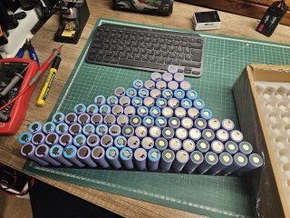

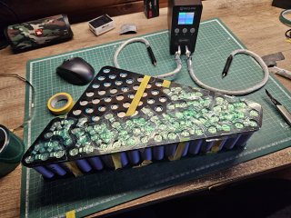

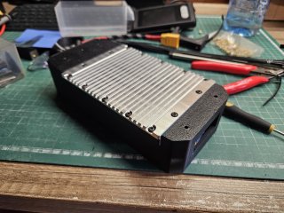

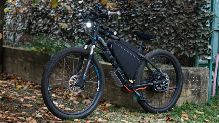

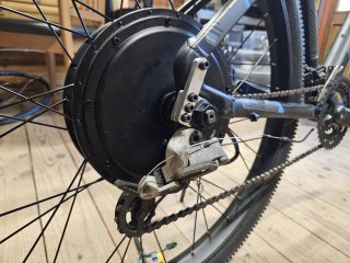

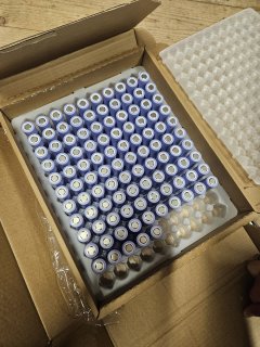

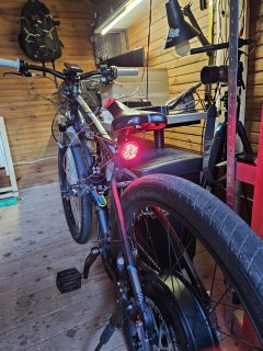

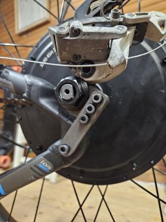

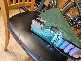

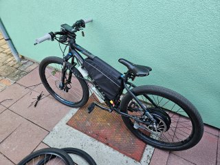

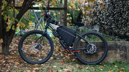

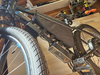

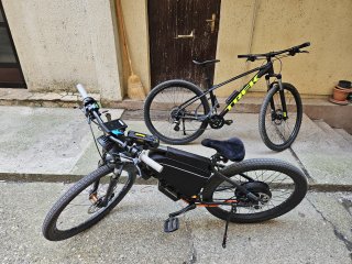

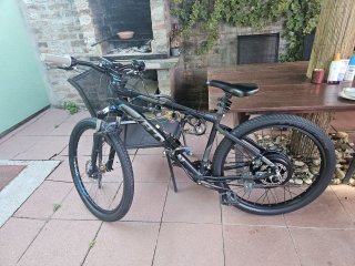

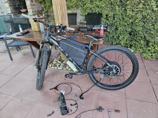

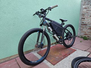

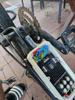

Last summer, I built my very first ebike, and there were a ton of things to learn and consider, so I decided to make a detailed post about the build to hopefully help and inspire people who are getting started.
Wow, nice build!

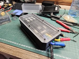

If you want to get the cell voltage telemetry into VESC, I have a project that does just that:
Wow, nice build!
Okay, this is so cool. I've been searching for something like this, actually... How precise do you find the SOC monitors in VESC and inside the JBD app? My issue is that I have a 12V buck converter that is connected to the battery, after BMS, of course, but it pulls very tiny current, and over a week or two, it does drop the voltage of the battery a little bit, but this loss of capacity is never recorded on the JBS BMS because the current is too low to be picked up.

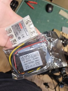

The buck stays on because it also needs a soft start circuit with a big resistor in series to prevent sparks, so switching it is not really easy. I made two sets of connectors, one for power and another for precharge. I always connect the precharge first, which has a ceramic resistor in series to lower the current to the capacitors. After a few seconds, I plug in the other line for power. One of my buck converters blew up before I started doing this.

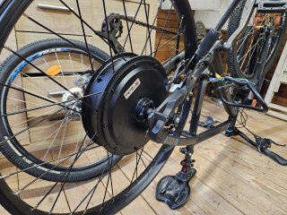

Update:

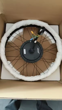

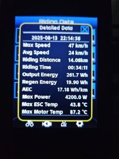

I got the 5T motor. I tried to tune it for a week, but it's just too weak. Anything over 100 phase amps and it loses sync.
I couldn't test the temperatures yet because it's still cold out. The average efficiency seems the same. With 100 phase amps, I'm getting incredible torque at start, but as soon as the wheel starts spinning, the power drops massively, and if I keep full throttle, the motors start making weird noises, going out of sync, I presume.
Here are my current settings:
Motor Type: FOC
Sensor Port Mode: Hall Sensors
Motor Current Max: 100A
Motor Current Max Brake: -100A
Absolute Maximum Current: 250A
Slow ABS Current Limit: False
Battery Current Max: 100A
Battery Current Max Regen: -20A
Battery Voltage Cutoff Start: 63V
Battery Voltage Cutoff End: 60V
Battery Voltage Regen Cutoff Start: 80V
Battery Voltage Regen Cuttof End: 84V
--- ERPM SETTINGS ---
5T Kv: 7.15
5T Pole Pars: 23 (46 magnets)
RPM @84V: 7.15Kv * 84V = 600.6 RPM
Max ERPM: 600.6 * 23 = 13813 ERPM
Max ERPM: 20000 (increased to 20k, field weakening buffer zone?)
Max ERPM Reverse: -10000
ERPM Limit Start: 80%
I did FOC measurements multiple times, always got similar values:
R: 76.68 mohm
L: 214.40 uH
Lq-Ld: 63.91 uH
Motor Flux Linkage: 28.677 mWb
KP: 0.4288
KI: 157.36
Observer Gain: 1.22
Saturation Compensation Factor: 20%
Temp Comp: True
Phase Filters: Enabled
Zero Vector Frequency: 30 kHz
Observer Type: Ortega Original (I tried cutting observer gain in half, which helped a lot)
MTPA: I didn't mess with (edit: MTPA was set to IQ Measured)

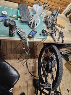

I did some more tuning. Got it to 100 phase amps without desync on full throttle, but it vibrates really badly in mid rpm. Also, I tried to spin the motor one time while holding it in the air, and when I gave it throttle, it desynced and started making "machine gun" noises. So my parameters are definitely not right. I noticed that saturation compensation helped a lot. I'm at around 40% currently.
Increasing the time constant while measuring FOC parameters increases the resistance. Both resistance and inductance change depending on the time constant value. I was measuring FOC parameters with phase filters ON.
At 800us, my resistance was around 80mohm, at 2500us it was >120mohm.
Also, I'm quite limited with top speed, with field weakening, I'm getting maybe 60kmh, but it takes ages to get from 50 to 60. I knew this could be a problem, but I was expecting crazy torque and was fine with lower top speed. If I don't get the 5T tuned correctly soon, I might switch back to the 3T, since it was way more stable and had stronger torque.
Resistance and inductance shouldn't change with time constant changes, probably it's just not reading them very reliably.
The lack of top end power could just be the higher turn motor, you can't cheat physics but it could also be the same issue I had where it wouldn't run the duty cycle high enough. If you watch the real time data during a pull the current should go to your set point, stay there as the RPM increases and duty cycle increases until the duty cycle gets to around 90% or somewhere around there and then the current will start falling. May not be able to see this very well unloaded as it will happen too quickly. The issue I had was duty cycle would never get that high, only to like 60% or something and current would start to fall, improved it with a lot of frocking around with the PI controller but it seems there was enough noise that the PI controller just wasn't responding well. I think VESC should be able to handle this better but it's hard to blame Benjamin for not optimizing for crappy hardware and issues he may have never experienced while developing on varied but all reasonable quality hardware.

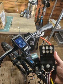

I updated the VESC! My VESC shipped with a 6.02 75_300_R2 target. I updated it to 6.05 FSESC_75_200_ALU, did the setup again, and I'm at 160 phase amps!
But the motor vibrates like crazy in mid rpm, and my handlebars are shaking. It doesn't desync anymore, though.
When I give it throttle from a stop, it's smooth until it hits mid RPM, then it starts to vibrate, and after that period, it stops vibrating and becomes smooth. I think it's not electrical noise from high currents because after the vibrations stop, I can still see high phase amps in the real-time data display.

you can try and add more hall sensor samples, start with 5 and experiment with it. By default it's using just 1 sample, worth a try.

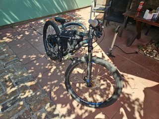

I got rid of the vibrations! 190 phase amps no problem! Can't keep the front wheel down :LOL:
Finally, some good news, I'm gonna post all of the settings to help anyone with similar issues.
MXUS 3K Turbo 5T + VESC FSESC 75200 Pro V2.
First of all, I upgraded the firmware. The VESC shipped with firmware 6.02 and the target version 75_300_R2, which I think is incorrect. I manually downloaded and flashed a new firmware from the VESC firmware archive. I updated to version 6.05 and hardware version FSESC_75_200_ALU. I'm not sure if this is 100% correct, but everything works fine for me. This actually made a huge difference in the stability of the motor.
First is the FOC calibration. I asked the manufacturer for the exact resistance and inductance of this motor, and they said it's 72.91mΩ and 222.37µH.
I did the measurements with a 4000us time constant. My resistance is: 78.1 mΩ, and inductance 195.75 µH. Ld - Lq: 40.80 µH, Flux Linkage 35.193 mWb. Current KP 0.1958, Current KI 78.13, Observer Gain: 0.80.
Openloop ERPM: 300, Saturation Compensation Mode: Factor, with 30%. Sensored ERPM Start 1000, Sensorless ERPM 2000, Hall Interpolation ERPM: 500.
Phase filters are disabled because this hardware version does not support them. Zero Vector Frequency: 15.0 kHz (lowering this stopped the vibrations in mid rpm). Control Sample Mode: V0 Only, Current Sample Mode: Longest Zero Time, Current Controller Decoupling: Disabled, Observer Type: Mxlemming Lambda, MTPA: Disabled, Speed Tracker Position Source: Corrected Position.
I just went for a short ride with the battery at 80V, and the front wheel is lifting super easily. The vibrations in mid rpm are gone since I lowered the Zero Vector Frequency. The downside is that now I can hear the motor, but it's not a big deal for me. I pushed it to 190 phase amps and decided it's enough for now. I will definitely try to push it even higher later. I got 8.5kW peak with these settings with 100 battery amps on a 20S pack.
