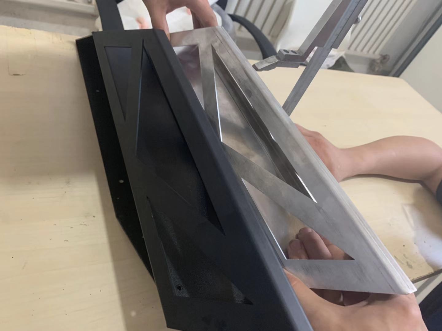

Update 20190806/07/08 :warn:
【1】
In order to reduce weight and maintain weight balance. We will eventually use this battery box design in the 400w/800w motor version. It is divided into two parts: anti-collision board and battery box. All use 6061 aluminum alloy. T4/T6 was heat treated. Cutting is done by wire cutting equipment/laser cutting equipment. The anti-collision panel is triangular in design, which can buffer and protect the battery and frame when receiving the frontal impact. The battery box is oxidized. Then we mark our logo by laser engraving. It looks good.

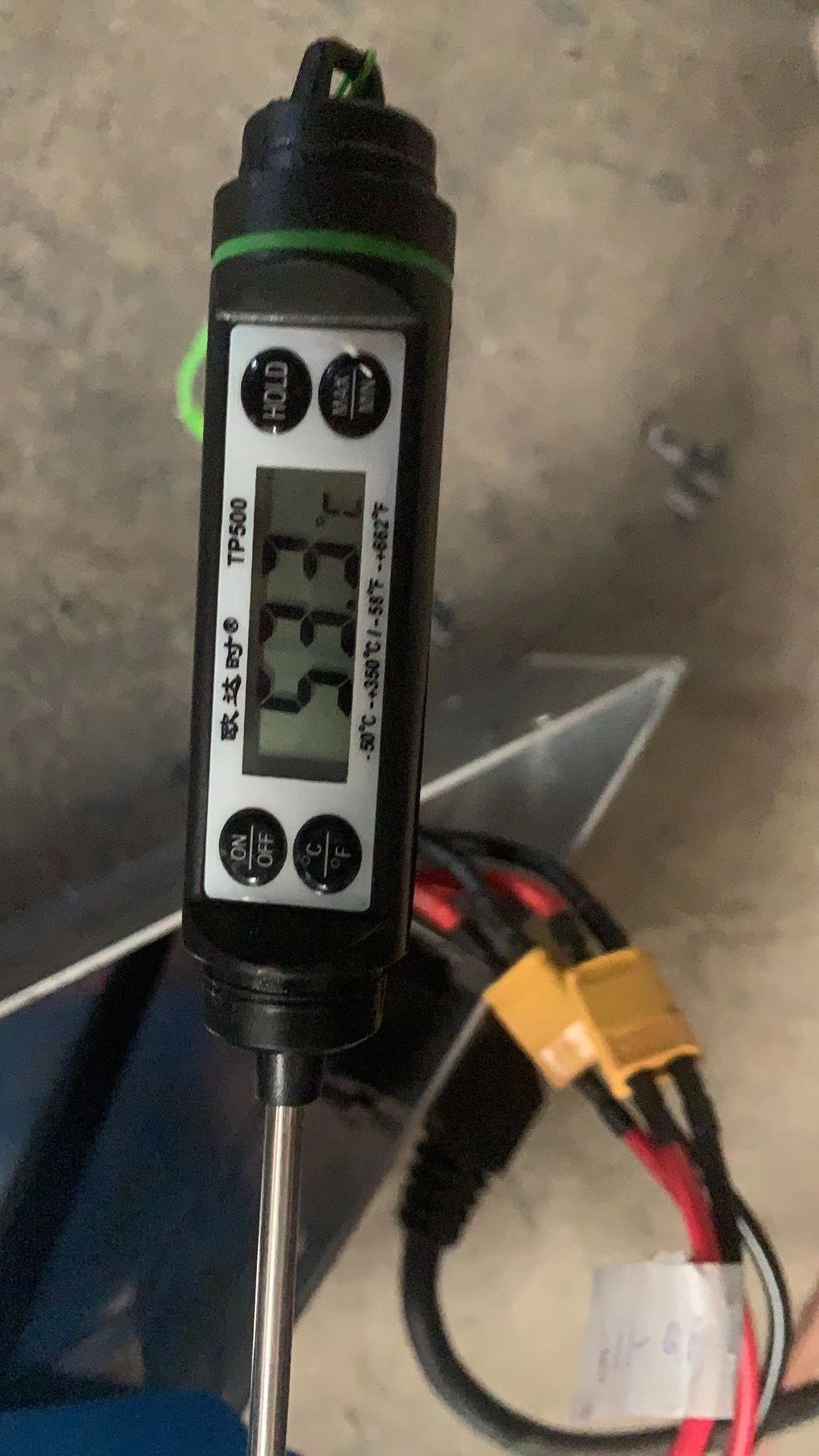

【3】
A sample was reproduced and sent to my friend's Laboratory for testing. Collision, high temperature, waterproof, etc.
The welding hasn't been grinded yet. It's a bit ugly. :mrgreen: :mrgreen:
