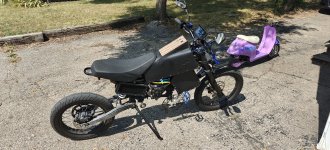

Joe's E-bike build
It's made from the drivers side front fender of an 03' LeSabre. Still haven't painted the bike yet. I put a DNM rear shock on it because the other ones were just too soft. The old ones had 250# springs and the new single shock has a 1000# spring. It's stiff but I'll be using this for groceries etc... so the extra weight capacity will be needed. I'm planning on putting bags on the sides of the seat.
I put a big spring inside the fork to stiffen it up. I got the spring from work. It goes into a folding cafeteria table to assist the user in folding it up. It was about 3ft long but I cut it to the right size and it ended up working out. The tire doesn't rub the battery anymore but I'm still going to stretch the frame out about 2" when it comes apart for paint. I need room for a fender and I'd just feel better knowing the tire has plenty of clearance.

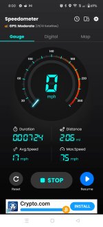

This is a screenshot from the top speed run I did. I only held this speed for a short time. I don't think it's smart to go this fast on the BMX front tire. The sidewall is too soft. The bike was actually very stable at that speed but I'm sketched out by the tire. Had to test it out though now that I'm more confident on it. Overall, it rides pretty good. I sit upright and it's comfortable. The turning radius is wide with so much rake. It has tons of torque even with the small controller. It's a far driver nd72360. 180 line amps and 360 phase amps. I think that's more of a peak rating honestly. It won't wheelie but from about 20mph on up it takes off like a bat out of hell if you give it full throttle. When I chose the pulleys and sprockets I sized them for the peak torque to be in that range. Video coming soon.

Since the last post I've added a few things to the bike. It has a front fender, turn signals, rear disc brake finished, paint, the battery is sealed with RTV and coated entirely in flex seal, removed coolant flow indicator and installed coolant reservoir instead, and added box like structure on top of the fairing/cover for the switches.
Those last two pics are from the day I painted the frame. The cooling system and brake caliper are not present.
I made the rear caliper bracket out of the thickest flat stock they had at Menards. It has a bushing welded into it and the axle goes through it. The part that extends forward has a slot in it that engages the big pin on the inner part of the swingarm. It can slide forward and back with the wheel to allow adjustment of the chain. The caliper is a front caliper for a Honda application.
The swingarm will be painted at a later time. I may need to weld something to it first. That's why I didn't bother taking it off or masking it when I painted the rest of the frame.

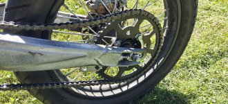

I put a fardriver nd721800 on the bike. I initially set the line amp setting to 400 amps. The belt stripped and broke when I gave it half throttle. It tore the teeth off. So I replaced the belt and set the tension extremely tight. It was still doing the same thing so I switched to a chain
The chain was able to handle slightly more but the chain was jumping too! So I've determined that it's the amount of flex in the motor mount bracket causing the problems. I haven't done anything to strengthen it yet but that's going to be my next move. The QS138 has a ridiculous amount of torque at 400amps! The motor bracket is not thin steel but it's bending it like it's cardboard. Part of the problem is due to my low gear ratio. The chain/belt driving the jackshaft sees much more torque than it would if I geared it shorter. So, I could just put a larger sprocket on the wheel and I'm sure most of my problems would go away, however, the motor RPM stays low with the current setup and I like it that way. The motor stays very cool and it's very efficient while just cruising around at sane speeds(which is the primary purpose after all) 😉. With the chain setup I have a 13t on the motor and a 20t on the jackshaft. 20t and 35t on the wheel chain. This setup is a 2.69 ratio. The bike still pulls like a bat out of hell and reaches 70mph+ easily. I have to say that I'm very impressed with the QS138 having come from a background in ICEs and never having built anything electric like this.The torque is insane!

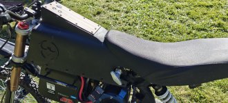

I also put a different seat on it which I think is much better.1000011031.jpgthis is a Chinese ATV seat. It even has a little latch on the bottom for easy removal which was pretty simple to adapt to the frame. I no longer have to unbolt the seat and it's much more comfortable being so much wider.

Made a stronger motor mount because the old one bent/twisted from the torque.
This is the old mount. It's clearly not strong enough.
The new one isn't adjustable and it's made from much thicker steel. I have zero flex issues now!
Constructed a new cover for the wiring and the larger controller.

I put a 53 tooth sprocket on the back. It has so much torque like this that I can't give it full throttle from a stop. It will loop. Easily does wheelies with this setup. I think it's too much though. It still gets to 83mph like this but there is much less torque on the top end. The motor gets too far out of it's efficient RPM range. I have another sprocket to try when I put the shinko 244 on the rear. It's a 41 tooth I believe. I think that will give me a happy medium between the super low gearing I had originally and the gigantic 53 tooth.

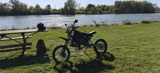

Just a few pics of the bike I took at a park the other day.
