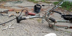

I got to work on my frame today. Initially I was just going to lengthen it but once I got to that point I decided to extend the rear of it as well. I'm trying to end up with something like 20-24" between the seat and the pedals without making it too tall. It ended up working out pretty well I think and with the way I did this I retained the same spacing between the shock mounts. It welded up pretty well and I love having a real MIG.
The gray one already had the headset tube(I'm not too familiar with the technical terms of a bike frame. I learned bikes by taking them apart and building Frankenstein bikes as a kid) sawzalled off so I cut the front part off the black one and used a piece of tubing with the OD matching the ID of the frame tubing as an inner sleeve to reduce the direct stress on the weld. This tubing is pretty thick so this may not have been necessary but it gives me peace of mind and it also helped keep things aligned without making some kind of jig.
I cut a slot like this into each frame section to weld them directly to the sleeve. I didnt have any drill bits available to do plug welds.
This was where my original plan ended but I started brainstorming how I will do the crank and where the pedals will end up and I just didn't think they would be in a good spot no matter how I did it. So I decided to extend the swingarm mount downward using the remaining part of the black frame.
I cut the seat bracket off so that I can move it a few inches upward and forward to keep it in a good position.it would have been too far down had I left it in its original location.
This is where I ended up when I quit for the day. I don't think the neighbors were appreciating all the grinding and I was getting tired of it myself. I'll head over there next weekend to finish removing the remnants of the various brackets and such that I cut off and to re attach the seat support/bracket whatever you want to call it. I'll be making some kind of seat myself. My sister wants to do the upholstery work for it

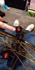

Some small updates. I got the spokes and laced up the wheels. The rear was difficult and I probably should have ordered the spokes 1mm longer. I went with 14g spokes and the spoke head washers worked perfectly. My paranoia about the online ERD specs was unfounded. My measurements came out exactly the same as what I found online. Still, better safe than sorry. I didn't have any spokes to use for measurements so I used zip ties cut to a length I could measure with my caliper and threaded them through the spoke holes. I got forks from aliexpress. They have a rebound adjustment and an air chamber. They also have a lockout that I will not likely make use of. I read a lot of negative things about Chinese forks around the net but I couldn't find any specific horror stories about them snapping or something like that. In all honesty they look strong to me. The triple tree part even looks solid which kind of surprised me. They are a little bit long for the bike but I think it will still work out ok. I also ordered the motor. I chose the water cooled qs138 90h. It comes with a sprocket and it's the hall sensor version. I believe it's a 428 sprocket however. So I will probably not be able to use it since the rear is for a 420 chain. Once I have the motor in hand I'll try to find the right sprocket but if all else fails I'll just weld a 420 sprocket onto the one that comes with the motor. I've been designing a controller based on the Lebowski brain. I haven't ordered any of the components or boards yet. That will be next paycheck. I really like the idea of having a brake lever to control Regen braking. I think that would be so cool. Here are some pics of the parts.
Spokes
Rear wheel laced. 3 cross pattern.
Front wheel
Forks
