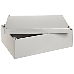

Agnius, check out this polycarbonate case that will fit your battery pack perfectly:
http://www.amazon.com/BUD-Industrie..._6?s=industrial&ie=UTF8&qid=1346993682&sr=1-6
BTW, that 4S1P pack has worked perfectly in turning over what is a very high compression motor in my Porsche GT3. The starter motor actually spins the motor up faster than with my previous 25lb AGM battery and even though the alternator in the car only outputs at 14.0 volts, the cells have kept charged at 90%+ capacity.
Hi Steve. Thanks for the link. I think i will need those terminals you were talking about on Porsche forum. Combined with this box it will make one sexy battery. Cheers

I have build myself vacuum forming machine. Will try to make battery case to sandwich bottom case my kit and top cover to form protected battery. I am thinking perhaps making 12S, 16S, 24S complete battery packs (-BMS) available to Europe. Just thinking stage at the moment as few vacuum formed samples did not came out right. i have to consult someone who is doing this type of work. I am thinking, i need right molds to get it up to selling quality.

I am trying to sort out enclosure for these kits to build up nicely into sealed battery pack. Would use 3mm polypropylene for cell enclosure and 2mm for top cover:

Got some pricing on the enclosure. Bottom sections needs to be welded, top section vacuum formed on negative mold. Molds are 70USD for 6S probably more for 12, 16, 24S. Complete pricing looking high.
Paul sells 12S for 590USD and my approach would bring me to 700USD.
