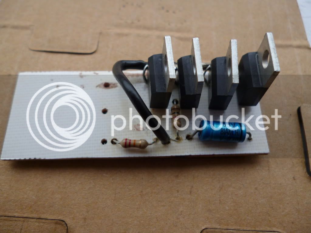

Diamondback said:
Can anyone spot what I have done wrong?
When it was connected, everything was off; perfect. When I turned the switch on though, 2 fets blew.
All though the solder looks very close underneath, there wasnt any solder that had bridged.
Oh my, Photobucket causes my computer to crash in a bad way. :(
Anyway, the schematic you are using is a proven FET blower. Several members have tried it with the same results. Sometimes repeatedly.
I suggest using the version shown on page 6 of this thread.
As far as I can see you've done everything right. What voltage are you using and what value are the resistors?
I wasn't thinking when I did mine. The back-plane is connected to the middle leg, so you can lay them flat and get better spacing of the two power wires.. Looking at yours, you've soldered to the thin part of the leg, which will heat up and melt the solder. Much better to solder the thick part.
Here's mine:
