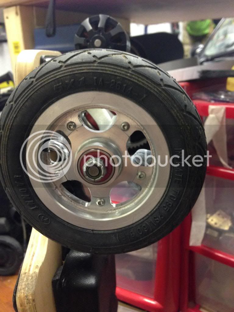

I've completed the design and I'm in talks with my CNC Manufacturer to get them at the best price.
They pretty much look like the above wheels but 125mm ..( the 3 piece hub/ rim design is the only way really) and I'm also talking to a supplier for the tyres and inner tubes ..
ooh and my wheels will be all alloy not with the plastic rims.. :D

( the 3 peice hub/ rim design is the only way really)
The Trampa Superstar wheels have 5 parts so I wonder how you solved it?

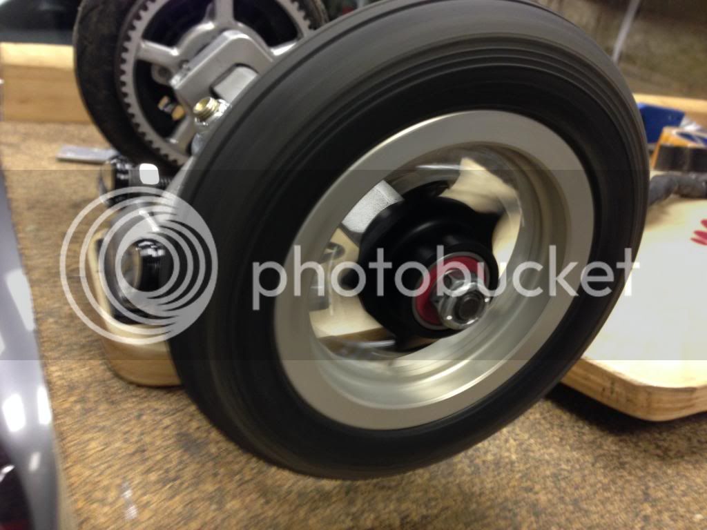

i've been through a few protoypes but i've got the wheels running smooth as silk..the range will be loads better now..
I just need to get them anodised..Black and Silver or shall i add some colour? and they just weigh a couple of grammes more than the plastic rims..
[imghttp://i1309.photobucket.com/albums/s621/richard_bailey1/IMG_1804_zps050354ff.jpg][/img]
Nasty Plastic rims -

Nice new Precision Machined 3 piece -running perfect!! they run for ever!! ive also got a counterbalance for the valve on their-which is actually a piece of blutac..but it wont be on the production run.. :D (that's the Tyre wobbling by the way)

Cool! Good job:) Do you have an exact weight for a complete wheel? They make up for an easy tire and tube switch. No rush, but when do you think they will be available in your site?
I'll weigh one but just by hand there the same weight really as I use smaller bolts on mine .
I've made 4 so I can test them first so after a good few miles testing . Ill then get a batch made .
I should think around 1-2 months before there ready for sale as the weather is a bit poor and they have to be tested before I sell them to the public ..it's a dirty job but some one has to do it!! lol
I will say the ride of this board with the pneumatic tyres is simply awesome .. It goes anywhere !
What a result!! Not only do they look nicer,are stronger and run far smoother.....They are also lighter than the plastics wheels!! Now that's Engineering!!!

Great! I have had 2 flats in three days now and the skike wheels has a tight fit. I ended up making more holes in the tube trying to get it out. So looking forward to use your 3 piece design. If you have the option from the supplier to get a bit thicker rubber than the skikes have you should go that way. I see that skike have made some thicker 150 mm tires due to the previous tires puncture easily.
