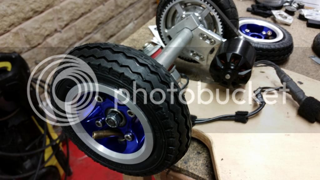

The enertion wheels have arrived and he's done a nice job... a few niggles...valve caps don't fit and there possibly a bit heavy but i can live with that...and i got stung with a customs fee of £21 ..which it seems everybody has..so he needs to sort his shipping company out..I use Royal mail and my customers rarely get charged..
They make my wheels look tiny... and im not sure how these will perform in comparison to my thinner wheels which i an run at 80psi.. rolling resistance may be a fair bit higher.... testing will tell...
I'm just machining up some prototype 60T 5mm pitch pulley wheels to fit straight on allow fitment to my drive kits..im hoping on an easy swap out with existing kits...

well the actual alloy wheels are well made and solid...but the its the tires that let them down..not round , heavy and too wide with a low 40-60 psi pressure which gives a terrible rolling resistance.....so at this present time i wont be making the 60T pulley for it..i have made 2 prototypes so i could ride the wheels.....but that's it.. If i could get 20 orders for the Enertion pulleys - i would get some made for you.. they are threaded so you just remove the nuts on one side and the bolts attach to the pulley instead..really simple.. pity about the tyres..although as you can see on the video my tires wil actually fit them..there a bit loose before you inflate but once inflated they fit nice...
enertion pulley-
The range on these tires is terrible compared to my 5" x1" tire..its maybe half again ..so from a skate wheel maybe 10-12 miles ..my wheels around 8-9 miles..these are less than 4 miles..and you don't really need to use the brake down hill it just coasts to a stop..
Don't get me wrong there kind of fun to use and ride over obstacle well but you can feel the wobbles at speed...and the range kills it for me really...so unless you want to double your battery size and weight...

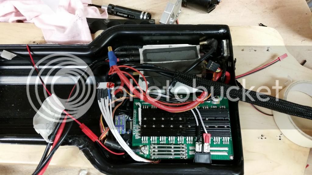

its been a busy Xmas at Alien and i've been putting together the test bed for the polymer wheels.. i originally started with a BMS fitted system but i'm having problems getting it to work..so i lashed up a quick setup with charging port to get me running..and actually it looks pretty nice in the smooth white finish..it matches the tyres..

The BMS setup..which has two charging ports the 5a for home charging and 2amp for my small power supply that i can take with me..:) first mock up
neatened LED wires and notice my polished Trucks...
The inside
And the white smooth box with charging port- not ideal but its got me moving.. the Alien power switch is a godsend for quick setups.
