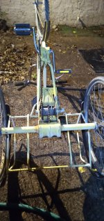

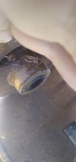

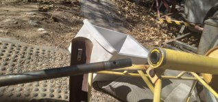

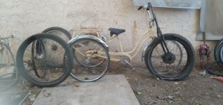

I got an old Schwinn Tri-Wheeler Town and Country (probably the 1971 or 75 or 78 model, based on info from bikehistory.org) from someone I knew from the Trashnothing/Freecycle list. Other than time-rotted tires (possibly original) and tubes, missing reflectors, faded paint, and a bit of rust here and there, and some other plastics that aged badly, it's in remarkably good shape.
1732147373373.png https://endless-sphere.com/sphere/attachments/20241103_193907-jpg.361493/ https://endless-sphere.com/sphere/attachments/20241103_193903-jpg.361492/ https://endless-sphere.com/sphere/attachments/20241103_193842-jpg.361491/ https://endless-sphere.com/sphere/attachments/20241103_193832-jpg.361490/ https://endless-sphere.com/sphere/attachments/20241103_193823-jpg.361489/

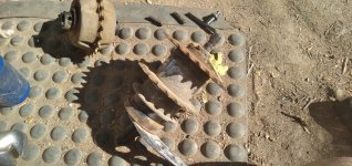

It also has a real differential in back, driven by a Shimano 3-speed hub 333 variation that Schwinn rebuilt the casing of to have an output gear on the casing isntead of spoke flanges, so the pedals drive both wheels. (the schwinn trike rear end I built SB Cruiser around only drives the left wheel, but uses normal wheels, appears intended to convert a schwinn 3-speed igh type bicycle into a trike).
The coaster brake in the IGH operates on the rear wheels because of this, so it does have rear brakes as well as typical 70s type basic caliper on the front.
Steel rims, 28 spoke 24" wheels for skinny 1"-ish tires. Nothing left of any markings on the tires, so don't know for sure what width they used to be. The hubs are the type that mount to the transaxle, without bearings in the hubs (those are in the trike module axle housing)
Ashtabula / one-piece cranks, singlespeed front directly to the IGH input. Chain appears original and has no problems turning, but could certainly use some oil. ;)

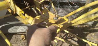

The trike's rear wheel module has a center housing twice as wide as that on the SBC, with two finger holes to help with chain install/etc.
So I can easily put a middrive on it for primary drive, and a front hubmotor for redundancy and extra power if I need it for loads.

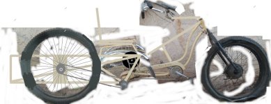

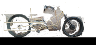

This is the initial sketch for conversion, based on SBC MkII thoughts; I need to redraw it "from scratch" to make it clearer and easier to see stuff:
There's a fair likelihood the rear wheels would be at least half a wheel farther back, possibly a whole wheel farther back, making the trike that much longer. But I may start with it this way. Part of it depends on having to get it around a couple of corners at work to get from the front door to the breakroom I have to park it in. (can't really make it wider because of that).
The major changes are:
--move handlebars to a tiller and point them back for comfortable angle when seated the way I ride.
--change fork / front wheel to 26" from 24", which angles the frame back several degrees. (the SBC has a very relaxed HT angle that hasn't caused any serious problems, so this one will probably be ok this way...if its' not, I can always change it).
--possibly add a "toptube" from the headtube to the point the trike-module bolts to the frame above the IGH.
--probably cut the seattube and seatstays off at the intersection with this downtube, to minimize stuff in my way of getting on and off.
--remove the rear wheels and fenders, and make new "hubs" that are just sprockets
--tilt the frame even further down so it would just clear the typical curbs / speed bumps I encounter, perhaps a handspan off the ground.
--Build a subframe that goes inside the wheels (the image shows it outside the wheels but it woudln't be), that also goes up to secure the seat to, and creates a "bay" for a lockable cargo area behind the seat, and a separate one under the seat.
--Use 26" fat tire (pair of 3" I have from a scrap bike) wheels on the rear, that will need custom hubs that allow sliding onto a fixed axle on the subframe, that have both a disc mount and (probably freewheeling) sprocket mount, to be driven from the chain from the transaxle "hubs" (thin gray lines).
A middrive can then be designed to drive either the IGH input, or the transaxle input (probably via the IGH output / shell since the transaxle input sprocket is cast as part of the TA housing, so I can't just bolt a second one next to it).
A hubmotor can be used in the front until the MD is designed and built, and for redundancy later.
If I keep the trike lighter by not building a heavy cargo box around the rear like SBC has, the small geared hub in front (a small bafang in the imaged fatbike wheel, and a different bafang in the ex-jumpbike wheel in the other images below) could "handle" the load, albeit with very low acceleration rates that might not be sufficient for the roads around here (SBC barely is, taking around 5 seconds plus to go from 0-20mph, most drivers are ok with that but some aren't).
I could move the rear GMAC into a 26" wheel (is in a 20" right now) and put that up front in the fatbike fork, and it would get me better acceleration than the little bafangs, but to really do what's needed I'll have to have the middrive (probably in addition to the front hub).
The subframe, once it's all welded up, can be made to bolt to the existing trike frame so it doesn't permanently alter the trike by having to cut and weld. I can probably make the toptube addon bolt on as well. This also gives me more options for experiments as I can build different subframes for different drive types....though it's not all that likely that I will, once it's working (there just isn't enough time and energy anymore).
I'll also build a canopy to cover me in the hot sun, since that has worked very well for SBC for a long time; I'm not sure I'd be able to ride in summer in the daytime without it.
Ideally I'd like to get a "new" battery (or set of them) to run it, so I am not using the "spares" for SBC (presently used occasionally on the lawnmower). At present the best option (because there's no expensive shipping cost) is these, but at $160 per 4s5p (20-cell) module, of which ideally I would need two, they're not really in my (nonexistent) budget.
They'd be easy enough to re-buss, cutting and reconnecting just the welded-on busbars
Unaltered mockup and detail pics below:

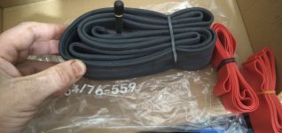

The tires already on the 26x3" wheels are knobbies, and while one is ok, the other's knobs are pretty worn down, so while both are afctually still holding air (the bike wasnt' used for years by it's original owner, so this is pretty good), I'll need new tires for them for reliability.
I have 26x2" tires off those old Jumpbike motor wheels that I could use, but they'll end up pretty thin over the wide rim spread out like that, and wouldn't do the job of bump absorption that are the reason for using these larger wheels.
I was hoping I could find a CST road tire in 26x3, but they only have a couple of knobbies in that size. Whatever I get needs to be a road tire (non-knobby), and a soft enough compound for good grip (like the CST City and Sensamo that I've used). Too many tires are made "to last" and so have hard compounds that have insufficient grip, so they skid during braking too easily, and slide around the road surface in cornering, either of which could cause a crash in the traffic I have to ride in.
My first few seconds googling finds this "deal"
which is $86 for two tires, two tubes, and two rim strips. My guess is they're not great, but they might be worth that price; many cheap tires are made from softer compounds, though I don't find any info on that for this brand/model.
Poking around the other results finds that most of the non-knobby options for known-brands (other than Kenda that I won't use because they *always* disintegrate their sidewalls and fall apart) would cost more than that for just two tires (not uncommon to cost that much for just *one* tire), and good thick tubes for this size run nearly $30 each in brands I know enough to trust (CST, Sunlite) not to fail in the usual ways (stems, seams, etc).
These cheap ones (Duro) are more expensive than some good ones at $140 / pair, probably because they're whitewall
If I use the 4" fat tire on the front, tires and tubes are even MORE expensive, and will probably cost as much for the one tire as the pair would for the rear, and a quick glance at google's results doesn't find a non-knobby version, though I'm sure there are some.
So I'd probably use the regular narrower-rim wheels that I already have various tires and tubes for, and a known-good well-tested (on SBC) brand/model to buy replacements if necessary (CST Sensamo Control 26x2).

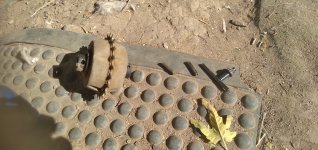

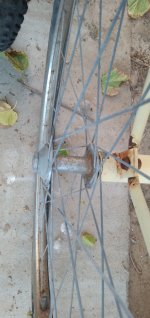

To build the hubs, axles, bearings for the rear wheels, regardless of tire/rim width I end up with, I'll use the bearings out of some old "Uboat" wheels I saved the cores of when the tires disintegrated and the wheels were replaced. They're basically like these 8" wheels
8" x 2" Red Polyurethane on Polyolefin Wheel - Precision Sealed Ball Bearing | Caster City
but the bearings in the ones I have are not separate per-side, they are full-width "needle bearings" within containment tubes with grease nipples. Just have to cut the plastics off the bearing to be able to put them into the wheel hubs. IIRC they're 1" I.D. I'm sure they can handle the weight loads, since the carts tehy're from regularly carry more than half a ton. RPM should be ok since they're from tiny 8" wheels pushed at walking speed (say 3-5mph), and would be on larger 26-27" wheels at higher road speed (20mph) Sort of like these https://www.amazon.com/Koyo-M-16121-Bearing-4300rpm-Rotational/dp/B007EDRR98
The hubs themselves I have various tubing sizes I can go thru to see what fits best.
The stub axles I don't know what I have that will work; they have to be stiff enough to hold all the weight even with the potential for hitting bad potholes or road debris. Don't know if I should use tubing or solid round stock.
If I use tubing, would it be better to nest multiple diameters one inside another, if I have some that will do this and closely fit?
I want to use single-ended stub axles for ease of working on the wheels if I have to do any roadside tire/tube repair or wheel replacement. As discussed in the SBC MkII thread, I would like to carry a whole spare wheel that can just be swapped out, at least for the rear.
Ideally I would use identical wheels front and rear with the same axle arrangment, so the same spare will work on any wheel, but since I would have to build a single-sided fork from scratch to do this, I don't have enough info or experience to be sure that would work. Plus I need to at least start out using a front hubmotor until a middrive can be designed, and probalby afterward as well, so it's likely that I can't go with the full application of this idea the SBC MkII would have.

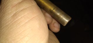

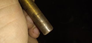

2.) The rear axle diameter on the current crop of deltas with cantilevered wheels is usually 5/8" or 15mm (yes, there are rare exceptions). And typically manufactured from A36 mild steel. Replacement axles made of 4130N tubing (from Acraftspruce) in .058" or .083"wall would be considered an absolute minimum suggested upgrade - however, this does not take in consideration the addition of cargo.
I won't be using the existing axle on it to carry weight; as noted in another post up there somewhere i'll be making stub axles mounted to the extension subframe for the rear wheels. the trike's present axle will only drive sprockets that then drive chains that drive the rear wheels.
But the info is still helpful in deciding what to make the stub axles themselves from. I don't have the option of ordering tubing (no budget; just tires and tubes will be more than I can really spend), but I can choose from whatever I've already got, including old cromoly bike frames. I don't know if it would structurally help to stack/overlap/nest (don't know the right word) multiple tube sizes that closely fit each other for the stub axles, all welded to/thru the mounting plate on the extension frame, and then welded to whatever securing method (bolt or threaded rod inside the tubing) I end up with for the nut to keep the wheel on the axle.
The stub axle outer diameter will have to be limited to the bearing size I have available on those heavy-duty needle bearings, which I think is 1" ID; still have to measure that.

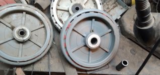

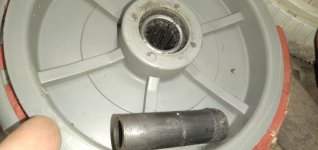

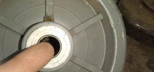

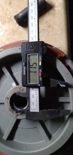

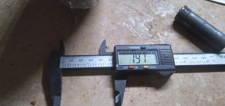

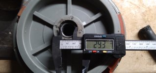

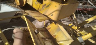

weird, the post i replied to isn't there anymore? :?

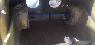

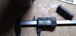

anyway, i had to get up to see what the schmoo wanted me to go see (just playtime, apparently, nothing really there), and took some pics (end of post) and measurements of those bearings. tursn out they're a lot smalelr than i was remembering; 1/2" in the center of their existing race according to both a handy drillbit and harbrofright digital caliper.

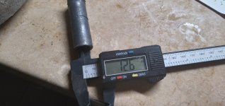

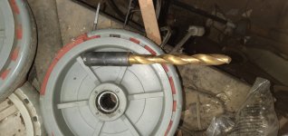

the race does not appear to be anything really hard metal-wise as there are gashes in one of them that had fallen out of the bearing and was under all the stuff the wheels were with. So i could progbably use the bearings directly on the surface of whatever tubing i use to build the stubs from without their cores, which means the max stub diameter is 0.72" (18.5mm) which google says is 18/25", which is probably really 3/4" at a guess.
on t he carts they come from the wheels are supported on boht ends of the axle, but they also can hold basically a couple thousand pounds per pair and still move normally, with most of the weight on these larger wheels and the rest on one end's much smaller casters (though those little wheels don't handle that much weight that well and have to be replaced now and then on the carts that get used msot often for that kind of weight).
bearings are around 80% of th width of the cage, which itself is around 80% the weidth of the wheel, which is about 2". so call it 1-1/4" for the actual bearng surface width if i did math right (not guaranteed).
OD of the bearing cage is about 1.15", 29.3mm, can't see the rest of the unit inside the plastic wheel so will have to recheck that when i eventrually cut a wheel open to take the bearing out, as i couldn't press one out by hand.

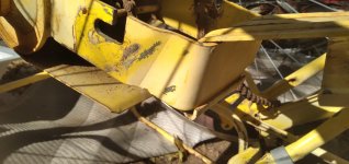

also "measured" the seat height of SBC goes to halfway up my thigh, but forgot to measure my leg before i laid back down to post this, so....a guess is that is around 28".
wheelbase on sbc is a lot longer than the schwin trike, which is what the extension frame is intended to help emulate, not sure how that affects the cog math, if it does at all.
keep in mind the scwhinns frame will be tilted down at the back to put as much of it as possible, and the extension frame's deck height way down low, so that as much weight of trike and any cargo will be as low as possible and still clear antyhgn i have to ride over on streets/parkinglots.
the front of the frame has to tilt up some to clear the top of the 26" wheel's fork, which will be that much taller than the 24" it was built for. but there's not much weight up front.

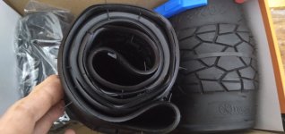

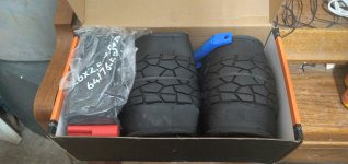

No physical progress yet, other than that the 3x26" tires/tubes arrived, and appear to be better than I expected. The tubes are thick types, rather than the paper-thin ones I thought would be included, and the tires are fairly thick and of a soft sticky compound. The rim strips are just plastic, so I will probalby skip those and use my usual gorillatape instead. Of course, that's after I design and build the hubs, and then unlace the 3x26" wheels to take the old hubs out, and replace them with mine and lace them up. ;)
Design of the hubs will partly depend on the drive system, and partly on the axle/bearing system (which I also have to design, based on the parts I already have around here).
Haven't decided on the middrive method yet. Have been doodling with the various ideas, want to do it up in a 3D program but unless I build the actual trike with correct measurements as a model, it wouldn't be useful for fitment work-out. So just doing it in paint for now. When there's time/energy I can hold up parts to the frame itself and see where they might fit for some better guesswork.
Paint sketches bottom and side view of a hubmotor driving the casing of the IGH (so it doesn't go thru the gearing, but does go thru the diff). It would have clamping dropouts securing it's axle to a plate that would bolt or clamp to the chainstays of the trike frame (as shown in the bottom view) or to the bottom of the seat mount (as shown in the side view); depending on how the motor fits within the framework. Output sprocket would mount to the disc mount of the hub, input to the ridge still present on the IGH housing.
(crossposted from the SBC thread to keep info on this build here)
I'll be using 26" x 3" rear wheels, because I have to build new wheels for it no matter how I end up using it, and I already have some rims for those on wheels from a junk bike, but they have worn knobby tires, with pretty thin casing between the knobs, so simply cutting off the knobs isn't a usable option. The size chosen is because 20" wheels on SBC are so small that they "feel" every bump, hole, etc; I've broken axles and a rim (and another rim on the old CrazyBike2 with it's 20" rear wheel). Tires/tubes are better for 20" because I can use moped 16" tires and tubes, which are more durable and cheaper than equivalent bicycle tires, and thicker, and often have better grip...but I really want a more comfortable ride without as much worry about breaking wheels and such, and bigger wheels roll over bigger stuff with less problem, so....
(suspension is complicated for a highly-variable-weight/loading cargo trike, and is another failure point, so I have skipped that on all the trike designs so far)
Why 3" vs more common and cheaper 2"? Because there's a lot more air in there, and that gets me that much more bump absorption, and more distance between the rim and the edges of holes / debris that breaks them. I can't always avoid those when traffic gets bad (and I can't just stop until traffic passes or I could be hit by cars that would otherwise just pass me if I'm moving (because some people are stupid)--even a graze at that speed difference could be fatal while it might just hurt a lot if I'm going my max of 20MPH), so being able to take the hit is important.
26x3 tires are in general fairly expensive, so for this experiment I started looking at the cheap stuff since I don't have the budget for anything decent (well, I don't have the budget for the cheap stuff either but I can skip enough household stuff temporarily for the option I found below). After a fair bit of poking around, and waiting to see what holidaze sales came up, I found these for about $60 (instead of the $90 they usually go for), by "YUNSCM" that I've never heard of:
Can't really tell much from the site page and pics, but if they weren't right I could send them back at no cost to me, and no shipping cost to get them, so a better option than anything else. No really awful reviews, and some positive ones there and elsewhere.

Easier (and safer) cargo carrying was part of why I built the SB Cruiser trike--more the wiggly kind of cargo, first Tiny then the others, but also heavy cargo like whole grocery carts full of stuff, liquids / sloshy stuff in whatever containers, and long stuff (boards, tubes, etc) I could carry on the rack on top (once I added that later on).
So I am thinking cargo like groceries or music gear or what I can get on to it from the hardware store. (bags of soil amendments or bags of steer manure for the lawn etc.) I am also thinking three wheels is probably a better option for me now-a-days.
Depending on the size of the things you need to carry, you might be better off with a more-scratchbuilt trike, closer to the SB Cruiser, or even better the MK2 version design (that hasn't been bulit, might not ever be just because it's too wide and long to take inside at work and park in the breakroom; SB Cruiser is about the biggest I can get thru the aisles to get back there--even a few inches wider just wouldn't make the corners in two places).
If you want to start a thread here in Ebike Build Threads for your ideal trike ;) we can work out what it will take to do that, and see how much you can build off existing parts and how much you might have to make from scratch.
This trike (the schwinn conversion) is going to take a fair bit of custombuilt framework to make the backend, not even counting the stuff I have to do to build the wheels (because I want single-sided axles so I can swap wheels roadside and/or do other stuff easily with them, which cannot be done with the SBC design as it is now (but could with the Mk2)).

Got the IGH and the diff removed so I could lubricate them and the axle bearings.
The axle is two halves, each cotter-pinned to the diff's output shafts, which are hollow tubes.
20250126_130439.jpg 20250126_130631.jpg20250126_130453.jpg20250126_130457.jpg
A drill chuck key turned out to have a perfectly sized rod for tapping out the cotter pins, making that part far easier than usual.
But as usual, actually removing the IGH and diff was quite a PITA, requiring unbolting the rear section from the "bike frame" to get first the IGH out (it's axle has to be rotated 90 degrees in the L dropouts of the rear frame in the process, and the angled dropouts of the bike frame don't allow that while still attached over the sides of the rear frame). Interestingly, the bracket that secures this section of the rear frame to the biek frame is not welded to the rear frame, it's just a folded tab that pulls on the front edge to keep it secure. Guess it works fine, as it was tight enough I thought it was welded until I loosened the clamping plate bolt and tried to move the frames apart.
Once the IGH was removed, getting the diff out was easy, simply requiring pulling the live axles out of it, twisting it at an angle to allow the chain/sprocket past the stiffening bar in front of it.
Before doing either of those, the pedal chain had to be forced up and over the pedal chainring, as it couldn't be detensioned enough to get it off normally, even with the frames unbolted from each other. Tehre's no master link, and the chain is "riveted" together in a way I've seen a couple of times on old singlespeed-chain bikes, which can't be undone with the chaintool I have. (it would require grinding away the spread-out "head" of the rivets, or even cutting a chain link out....there's a fair likelihood I can keep this chain on here and just lube it, so I would rather not cut it or otherwise render it unusable...the master links I have are not wide enough for this chain, IIRC. (one less cost to get it working, since my pedal input is not going to be driving the full load (I couldn't do that for very long at all)).
The IGH-diff chain was easy to get past once the IGH was not held by the bike dropouts (just by the rear frame dropouts).
The diff is not serviceable; it's casing is spotwelded together at three points to the sprocket in the center. I could probably drill and bolt the halves to that instead if I need to open it up, but for now I just dribbled some light oil into the bearing gap so it can have an "oil bath" for the gears, and to get some oil into the bearings on each end.
The Shimano 3SC IGH doesn't have an oil port like some of the SA hubs from that era, so I'll look up it's service manual or others' experiences to see if I can just get oil into it from one end or the other (like via the shifter-rod port), rather than diassembling it.
The live axle bearings spin pretty freely on the outboard ends, but the diff ends are not. I put a little oil in each and manually forced their inner race to rotate a bit, but it'll have to sit for a bit and see if it gets easier as the oil soaks in (I suspect there's grease and dirt in there caking them).
The schmoo was busy not caring, as hard as she could.

@Chalo @Papa @PaPaSteve (or anyone else with related mechanical expertise):
In this I'm-sick-and-too-tired-to-be-sensible ;) thought experiment,I explore the probably dumb idea of using IGHs as single-sided hubs in wheels on this trike.
If I were to create a "sleeve", threaded on the inside to match the axle (kinda like pedal extenders, but not; just something to "thicken" the axle all the way up to the shoulder / bearing face), secured to the axle itself with set screws or other (?) method to lock it rotationally, is it likely to allow using an IGH like these
from those old jump bikes
as single-sided axles safely, especially given that I am going to be loading them higher than typical with the trike and cargo weight?
They'd be used as the hubs of the two rear wheels, one on each side, with the sleeve fixed into a clamp (?) or other not-yet-thought-out method (that would be secure while riding but easy to undo for wheel changes/etc at roadside).
Chains from the trike's diff-axle ends would drive the inputs of the IGHs...the right wheel would require a chain outboard of the wheel though, so it would be harder to get it on and off, and it would also be pulling on an unsupported end of it and flexing the singel axle end, which is bad, since it would now be being flexed in at least two perpendicular directions variably for the whole riding times.
In theory (assuming I come up with a shifting method for both at the same time to keep them in the same gear) that would let me have gearshifting available beyond just the pedal-only igh that's already in the trike frame (the old shimano), so the motors could also have gearshifting and take a little less power for startups while having higher gears for the rest of the 20mph speed range, and the pedals could be kept in a different gear so i could still do whatever pedalling i can manage at various speeds.
It would also allow me to use the drum brakes in them for the rear mechanical brakes.
My brainfogged guess is that even if i can manage some mechanism to securely transfer torque to the frame from the igh axle for botyh braking and internal gearing, it would shear the axle off in short order from flexure stresses. :/
In that case, back to the original custom-version of the same kind of hubs already used for the split-live-axle the trike already has, except with bearings to ride on stub axles mounted on the frame itself, and disc brake rotor mounts on the inboard side for mechanical braking and parking brakes.
