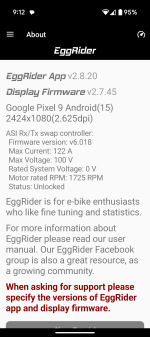

Hi everyone, I am almost satisfied with my asi bac855 controller with the acception of the fact that I cannot get my throttle to operate independently from my peddle. If I have my PAS on 1, my throttle will only go as fast as my PAS on 1 as well. Does anyone know what settings in ASI that I can change to enable my throttle to always have full power and full speed regardless of PAS settings? FYI, I am using bacdoor PC version (the older version) for my bac855 controller and eggrider display. I have played with all the settings in eggrider including power levels, power % and speed % but speed % seems to have zero effect on any number in there.

Is it the firmware on the bac855 or is it the Bacdoor app version? I have the older bacdoor software and I don't see that option on mine at all. image.pngimage (1).png
Is the bac855s firmware upgradable at all?
Also, does this mean that those options in features3 are not available at all on my version? Or do I just need to upgrade the software?
Edit it appears that I have the older firmware on my bac855. Does anyone know how to go about upgrading this? Can I copy the xml from another controller?
