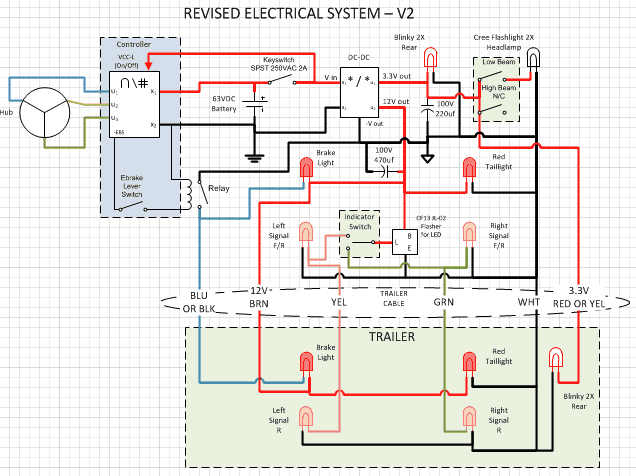

Today I focused exclusively on the integration of the DC-DC converter with the new cable harness and the new lighting system, with the keylock switch. This was really tedious work and taking far longer than I had anticipated. The short story is that my smoke test tonight produced no-smoke! Ebrake works as do the Blinkies.
For clarity, allow me to point to another thread to give you a flavor of the concept: Advancing the state of Ebike Electrical Wiring
I have modified the schematic yet a bit more from this thread.
![P1-Electrial-V2A.png](/sphere/proxy.php?image=http%3A%2F%2Fwww.hordsoffun.com%2Febike%2Ftrailer%2FP1-Electrial-V2A.png&hash=d812ceb58c1602c7adec37dddcac1e8c)
Mainly the big difference is that I decided to keep the isolated grounds for the +3.3V and +12V systems, although they share the same ground, and I added the trailer information. This site was useful in helping me select the common wire colors for the trailer cable.

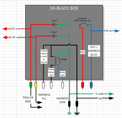

I also drew out a wiring diagram for Da Black Box, then printed both of these out to have at my feet so I wouldn’t waste time going back and forth to the computer.
![DaBlackBox.png](/sphere/proxy.php?image=http%3A%2F%2Fwww.hordsoffun.com%2Febike%2Ftrailer%2FDaBlackBox.png&hash=e14b4db62960cb7d5e3f54a564f98983)
