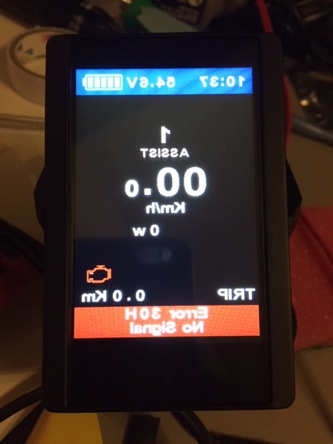

Flashed my first display using stlink and tought i screwed it up somehow because it went completly white after that
so i bought a new one and used the bootloader image and a uart adapter but with same result
does it need to be connected to a already flashed motor ? because i dont want to flash the tsdz2 until the display works
Dont know how to continue...any advice ?

Hi.
Seems there are out there different versions of the 850C :cry:
Just like you, an user had the full white display although the motor works as expected as also when changing the assist level on 850C, just the LCD is full white. Here is a picture of the 850C, that is full white with our OpenSource firmware but with a flashed firmware that was found online for 850C and that works perfeclty on my 850C -- as we can see, the image is inverted, meaning that there are different displays versions on 850C:
I will put a warning on the wiki about this and put max focus to try solve this. I already asked for ideas to other developers...
Can someone please donate to me that 850C version? because I can't debug and develop the solution without that 850C version.

bennyschudo and Eggybert, can you guys tell where you bought your 850C displays??
I sent a PM with my address. If both you guys can send me, will be great because I will need probably to damage the display...

There are different versions of Bafang 850C / DPC-14, some users are reporting that a specific version, the display stays full white and does not work with our firmware. The ones bought recently from PSWPower shop, the model P850C on this link do work.

I've bought a new 850C display and have a white screen issue, too. Sad. 75 euros wasted.
If anybody you guys are developers and have a white screen, you can help by debug the code. Please tell me and I will guide.
I can probably also get info if you give me the numbers from the back... At the same time I could try to get more information if there is a way we can tell for sure if it is compatible with what variation.
That way we can know what to ask suppliers (like to confirm serial/date on back before purchase) to ensure compatibility...
I'm thinking some is older stock, which is not compatible... Newer stock should all be same type now, however, I do not know for sure, this was just my understanding... Either way, may be able to get to the bottom of it from the manufacturer or at least an employee there ;)

Hi, I'm a C++ developer and I have white screen issue. I would gladly offer any help. I am digging into the firmware sources but without guidance I can barely get a grasp what's happening there.

Please debug the init of the LCD. Find where is the first time in the code that LCD get all white. Thanks.

It will take time, but you can put a while(1) ; after each init command. Out that while, build and flash, and see how the LCD reacts. I expect you can see something on LCD, inverted, before something is written and put full white - at least one user reported this.
Maybe the issue is not on init of the LCD but some write of data that will overflow and make the LCD full white.
