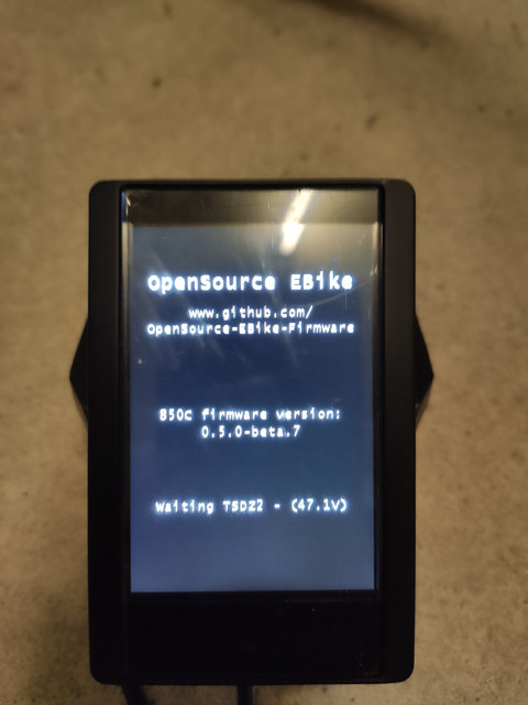

I'm also getting "Waiting for TSZD2" along with the battery voltage.
I've tried re-flashing multiple versions of motor and controller.
I checked the voltages on the cables from the motor:
Black (Ground)
Brown 41.7v
green 41.7v
white 180mv
orange 16mv
Purple 4.6v
This seems at odds with what I'd expect from this page: https://github.com/OpenSource-EBike-firmware/TSDZ2_wiki/wiki/Wire-850C-to-TSDZ2
Any thoughts?
This bike came with a XH18 display. I put this display on a bike I've leant a friend, which worked fine.
I've tried to put the VLCD5 display from that bike on to this. It comes up with all symbols solid on the screen. (ie 888 for numbers etc) Unplugging the brown wire (41.7v) lets the screen work normally, but it doesn't seem to be controller the motor - nothing happening.
I've reverted to stock firmware and gone back to custom too.

Have you flashed the motor with the correct version of the firmware ?
Yes. I started with the latest version of the firmware on motor and 850 screen and the screen correctly reports back the version for it's firmware.
Also tried an older version of the custom firmware on both and the original firmware on the motor (which I tried again with the VLCD5 display).
