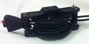

I'm guessing the cord pulls out of both ends just like the mouse cord. That would leave the whole mechanism to dangle in the middle between the rider and the bike.
You are correct sir. The spring that's in this prototype isn't strong enough to test it on the bike, but I'm hoping that by reducing the size/mass as much as possible ,and by it being under constant tension, it won't flop about noticeably. But, I'll report back when I get the next iteration up and running.
flyinmonkie said:
Would it be better to have it just pull off one end and have the reel in the pack or mounted on the bike?
On the pack is a no go, as I've proved with the bungee tube apparatus above. When the feed mechanism is on the pack, inherently the line will drag across the rider's body at some point. This could possibly be avoided by mounting it to a belt, but that further complicates an already complex solution.
Mounting it to the underside of the bike seat, like in a seat bag, though is another possibility. The problem with feeding the power cord out of only one side of a reel retractor is that the end that is connected to the hub must spin freely somehow. I looked inside a spring-loaded extension cord retractor I've got in the garage and they solved this problem by using a clock-spring type mechanism where the power leads are attached to a spring-loaded contactor that slides against a copper ring. Similar to brushes in a DC motor. Going this route may end up being the best solution, but it will be the most complicated. I've got some ideas to try though.
But if the free-flopping of this version is within acceptable tolerances, I may just end up with this solution

Thanks man. The easiest answer to your question is "options". Being able to use backpack mounted power give's portabiltiy and can be used on any of the bikes I've got. I've got a bunch of different frames (and some non-ebike things that need juice) and some of them don't fit batteries well. With the battery tubes I'm using now, I'm working on some frame mounted options for a couple of my bikes though too- nothing beats a solid mid frame mounted pack.
I've been running into issues finding the right spring for this device; unfortunately, it's not something that's stocked on the average hardware store shelves. I ordered a few variations of the "constant-force springs" http://www.mcmaster.com/#constant-force-springs/=m6344d from mcmaster, but these are wound backward to what I needed. I've taken apart a dozen different key retractors, tape measures and dog leashes in search of the perfect spring, but nothing has fit the bill. I think the retractor spring from a lawn mower pull starter will fit the bill best, but I've only been able to find these for sale online and I need to put my hands on it first to see if it will work.
In the mean time, I'm using one of the mcmaster springs wound backward against itself and it seams to be working so far. Im using the 2# pull force spring in it right now, but I think the 4# spring will work a touch better. Mcmaster also sells strips of spring steel if I feel particulary adventurous- not sure it's worth it at this point.
So enough of my whining, here's some updated pics.
I've changed the design up a little and tried to make it as small as possible. I've moved the bearings to sit outside the hub and made a "bent" side plate to hold everything in place. Working well, I'm happy with the package.
To help guide the power lead there's a couple pulleys on each end. I may experiment with a couple regular old hardware store nylon bushings and see if it works a little smoother than these ABS variants.
And to give some size perspective, here I'm holding it in my hand. It's not a huge device, but it's not exactly "invisible" either. It will flop around a bit on the bike, but I've not ridden with it yet. I'll report back when I do, maybe shoot a vid of the operation.

The biggest challenge I've run into regarding this retracting mechanism is sourcing a proper spring for inside the reel- I still haven't found the perfect one. As it sits, and as I've used it for the last month, I'm happy with the performance of the reel. It is smooth and only minimally invasive on the ride. The mechanism is under constant tension so it doesn't bang into the rider as often as I'd feared, but it's also not invisible. Ultimately, the best place for the batteries IMHO is on the bike, but this is turning out to be an adequate solution for certain situations.
