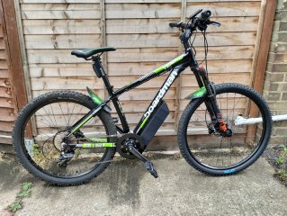

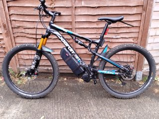

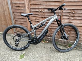

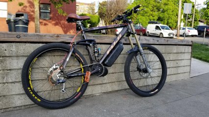

I run 2 batteries one on top of the downtube and one below which rests on the Bbso2. Use a rachet strap to get them tight together hard tail mountain bike handles great with this setup.
You can make it tidy, not all mine, just examples of what can be done.

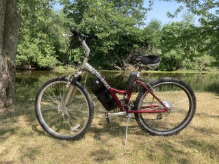

I tried this once, but Hailong cases vary. Some have plastic locking tabs that use the full case length. Some use less than half. I've seen the tabs break off in normal usage too. Velcro straps are needed for insurance.
The same applies to the mounting bolts on the cradle. Many are held only with two screws. You will want to use a steel bracket securely attached to the frame, and drill the bracket to take at least three screws for the cradle. This bike uses two 5mm screws for the water bottle plus two metal hose clamps to hold the bracket. Three straps on the battery.

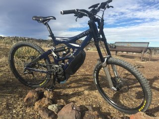

My long range e-bike with an inverted Hailong battery, I tend to be a fair weather rider my old bones will not take the damp, agree with water getting in, so may 3D print some cover sections to go between the down tube and the battery to help weather proof it to some degree.
