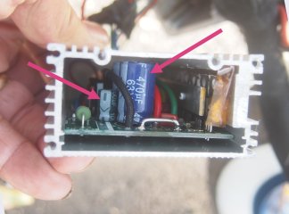

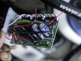

"Are there issues that could arise from using a 48V 15Ah battery with a 36V controller and motor?"
Yes, you could kill the controller. There are components inside it that are voltage sensitive. These include the electrolytic capacitors, the can shaped objects in the pictures. They come in various ratings, but 63V capacitors are in 48V controllers and 50V capacitors are in 36V controllers. They save a few pennies using 50V caps. A 48B battery is 54.6V at full charge. Running a 50V cap that high will shorten its life.
Sometimes, they use 63V caps in a 36V controller. Then you can overvolt it w/o the capacitors failing. Something else might fail though. These designs often have parts that overheat with time even with the design voltages.
If you're willing to experiment, blow things up, and replace them, then you might overvolt your controller. Long term, if you're building an ebike, or simply replacing the battery on an existing bike, I'd suggest staying within the original design intents,
