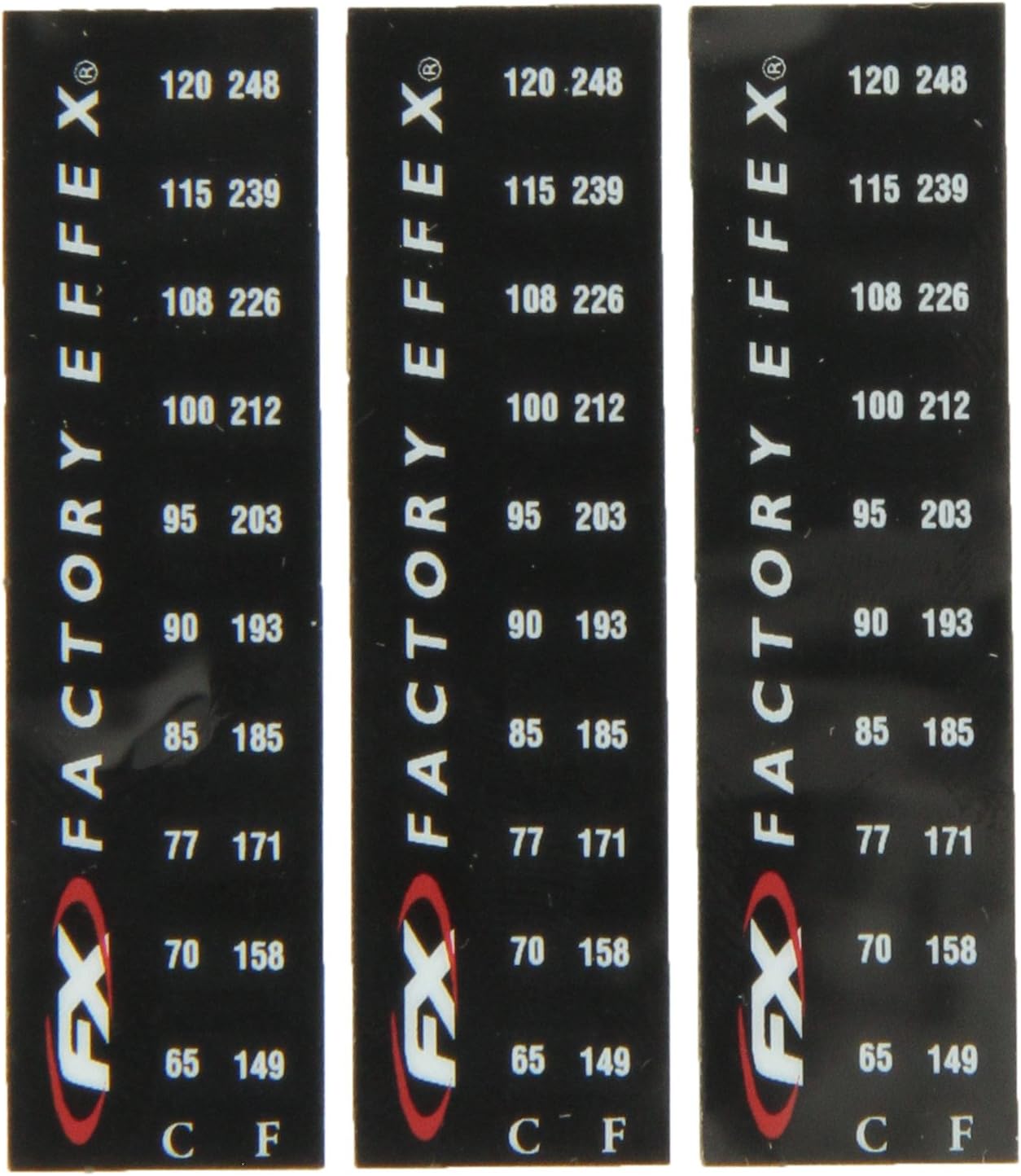

I'm an electric idiot so I'm wondering if there is a display that would give me better info on the condition of the battery and/or motor on my rear hub trike system. It's from gocarlite.com. My trike is my car so having info about potential issues before they arise would be really helpful so I'm not without transportation. But, as i said, I am capable of plugging plugs per instructions but not doing anything with naked wiring. Is there a swappable display that would drop in and give me better data? The KT LCD3 doesn't really tell me much, no motor temp or battery condition (other than watching voltage drop). Would I gain anything with a different display? Btw I also have a throttle if that matters.

A new display won't help you for things like motor temp, since you need a sensor in the motor to send that data to the controller, and then to the display.
Displays are manufacturer specific, so you need another KT display to work with your KT controller. Most KT display support the same functions, so changing it out may not help. If you want data, you could add a Cycle Analyst to your setup that will provide lots of data (Wh per mile, accurate battery levels, Ah used, min/max speed/current/voltage/power, etc.).

Some KT displays (maybe or maybe not LCD3, I don't remember) do support temperature reading, but only if there's a temperature sensor and you set the parameter that turns that feature on. All of the displays are interchangeable on any KT controller as far as I know. Plugs can differ, so that's something to be aware of.
If you download the manuals for the KT displays you have access to, you can read through the P and C parameter settings to figure out which display does more of the things you want.

You can take the low tech approach and buy a temperature sticker to put on your hub motor. As for the battery condition, it looks like that website sells kits, but they have standard 36V and 52V shark/jumbo shark batteries. You could buy a second battery from them or a reputable source like EM3EV and maybe get one with a bluetooth BMS as @docw009 suggested. You can get a battery that slides into the same cradle already on your bike. You could also get smart charger like the Grin Satiator.
