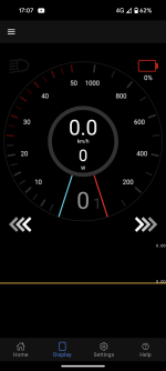

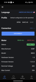

I found this out my ordering the program usb cable and hitting the display option I'm getting 0% and 0v. The really strange thing is the battery cut off voltage is at 41v yet everything works... Pedal assist and the throttle and all sensors....
So I've clearly damaged a component on the controller however I'm unsure what... Could anyone direct me in a direction of what is doing the voltage reading and transmitting this to the display?
