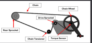

Here's another closely related drive. I'm sure this one well known here.
I wonder what the noise and vibration level is with the "lantern", or as the Anytime bike calls it "barrel cog" sprocket? If more (any?) of that style of sprocket, either as a drive sprocket or as larger diameter chainrings that could be welded to an existing sprocket, existed in the market it would be interesting to experiment with.
Picture an internally driven chainring like below, but with lantern gearing. It's what I was thinking of when I went searching for "lantern" gears on google and found this thread in Endless Sphere.
It allows closer shaft spacing than belts.
Open "barrel cogs" are relatively immune to contamination, mud, dirt, debris. Better than belts or gears.
Inside drive enables more meshing than externally driven. Quieter and better power handling.
Also it preserves the clockwise/counterclockwise rotation of the driveshaft as a belt would.
Ideally I suppose the chainring would be inside toothed with standard pitch sprocket teeth and the smaller pinion gear would be "barrel cogged" like the one shown in the first image. That would keep the larger ring lightweight. With a really well built "barrel cog sprocket" it might be fairly quiet indeed.

As i mentioned on the other thread..
.. this is just not a practical drive mechanism. The chainring teeth are too narrow to withstand the drive loads imposed by the single tooth to tooth gear drive. they will wear rapidly and most likely simply strip off if any significant loads are applied.
Chain sprockets are designed to transmit power through multi tooth contact with the chain.
Gear drives which operate with only one or two teeth in contact have much wider contact faces to resist the loading.
You would also benefit by studying the theory behind the different teeth profiles used on chain sprockets and gear sprockets

I didn't think the proposal was to use a standard chainring? It would certainly need to be hardened steel.
I think it's doable. Whether it's a worthwhile direction to take, I'm not sure...
I had always assumed chainrings ( quality) were hardened anyway ?
The problem is the limited width of the teeth (3mm ?), and even if using something like 219 chain that only becomes 5mm at best. The tooth profile is also not optimised for tooth to tooth drive.
Just a very poor idea from an engineering power transmission viewpoint !
Scanner's idea is for internal teeth - greater/smoother engagement. On my model, I increased the width of the internal teeth to 6mm, could be more...
Sure, it's a compromise but I think it's worth an experiment.....
The internal teeth version could be made with any normal gear profile & width, as compared to the original idea that had to use the external chain drive teeth which are constrained by the chain design.
Of course, but only the lantern gear version can be milled...
