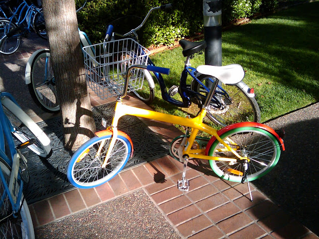

The citizen bike is available to us at some "reduced" (not really) price but that's not what we have around for us to use on campus. Most of what is there are a bunch of these (yes the ladies version :roll: ):
http://www.huffybikes.com/Products/Product.aspx?p=7&cat=5&subcat=17
Between bent pedals and chainguards, loose chains, ... you rarely find one that actually works.
But a few days after I posted they did finally get some special made citizen bikes (non-folding) for us to try out. They are much nicer... But they don't have motors :twisted:
