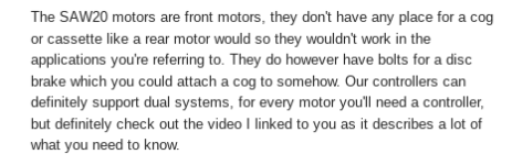

the brompton seems like the safest option for gettin' rad but i've tried their 250w front hub motor and it's ass , literally broke down on me as it has with tons of people. maybe the GRIN saw20 500w is better. They said it only does 52v but i think theres an adapter that lets you run it with their 72v controller up to 800-900w. But front motors are goofy, Sadly the Saw20 has no rear hub option, although they said maybe a mount on it could be adapted to run rear hub. Not sure if it would even fit the standard triangle.
i guess some adapters exist or DIY is possible Converting a front hub motor to a rear?
