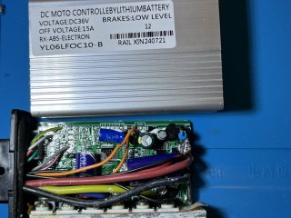

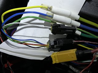

Is this cheap controller from the iScooter i12 FOC type? The manufacturer says it is, via an email response to my query. There's a 48 pin MCU. There's also a shunt that you can see in lower right corner of the circuit board pic.
The harness from the motor shows (from top to bottom), phase wires (yel, blu, gn), single white wire (1 pin connector), then 5 wires to 5 pin connector. Is this info useful in determining whether it is FOC or not?

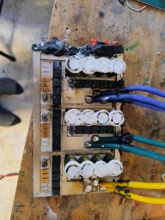

I had to open up my ESC because it is fried. I guess you get what you pay for on Alibaba. However my shunt-mod idea doesn't seem to be that stupid because the manufacturer actually has left two shunt slots without a shunt. My guess is that the same ESC (same transistor board, different Control-Board) is sold as FT85RS with a 550A rating.
So if I am able to fix this ESC I can also add one or two shunts per phase to allow for higher current sensing.

I don't fully understand the logic of thinking about shunt modding a controller you just blew up. Sounds like a great way to immediately blow it up again. At these current levels the Mosfets are not the problem, sure they can probably handle a ton of current and they probably did not blow from too much current or overheating. They blew because it's a shit ESC design that can probably barely keep the current stable, adding more shunts is only going to make the probably barely passable current sensing worse. With these cheap VESCs it's down a lot to luck and tuning skill. You get lucky your motor and tune runs stable at very high current or you spend a lot of time tuning it so it runs stable.
Technically you can't just install a no limits firmware and change the current to whatever you want, you'll run out of ADC range at some point. Technically a shunt mod gets around this but also decreaes the current precision at the same time which makes it harder to run well. I also think you may need to change the firmware so it knows you changed the shunts but not sure on that one. More importanly though you are shoving tons of current around a poorly designed board which casues all sorts of noise any problems that makes it hard for the controller to run in a stable fashion.
